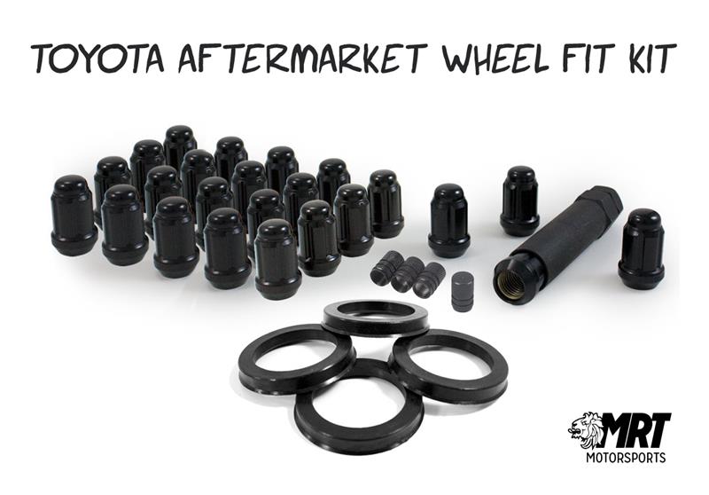

With the proper lug nuts and hub rings, there is no issue with fitting and running these wheels. We have sold several hundred sets of Method wheels to Toyota owners over the years, and we have never once had an issue with vibrations when using our wheel fit kits. To prevent the pain in the ass issue of the rings popping out everytime you change the wheels, just use a little super glue on the ring.
Ive got NVs on my Tundra, and Double Standards on my 4Runner. No issues after heavy offroad abuse.
If you can hubcentric wheels, you are going to be looking at SCS, FN Wheels or other OE Toyota models.
You can find them elsewhere, but I offer this package to make it easy - http://www.toyota-4runner.org/sale-...et-wheel-fit-kits-lug-nuts-hub-rings-etc.html
