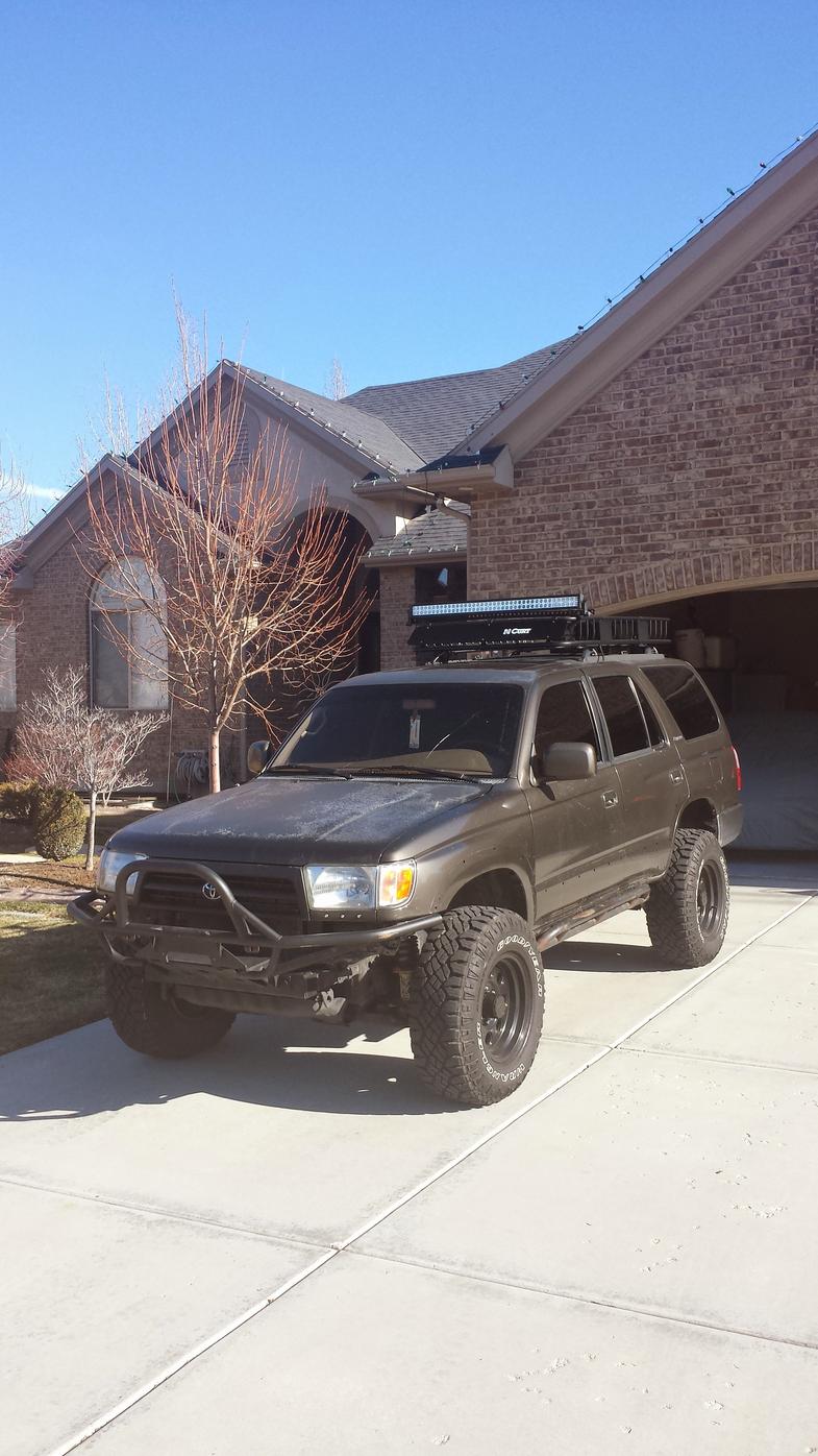

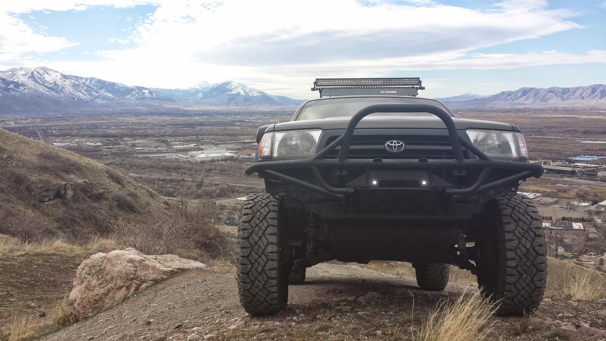

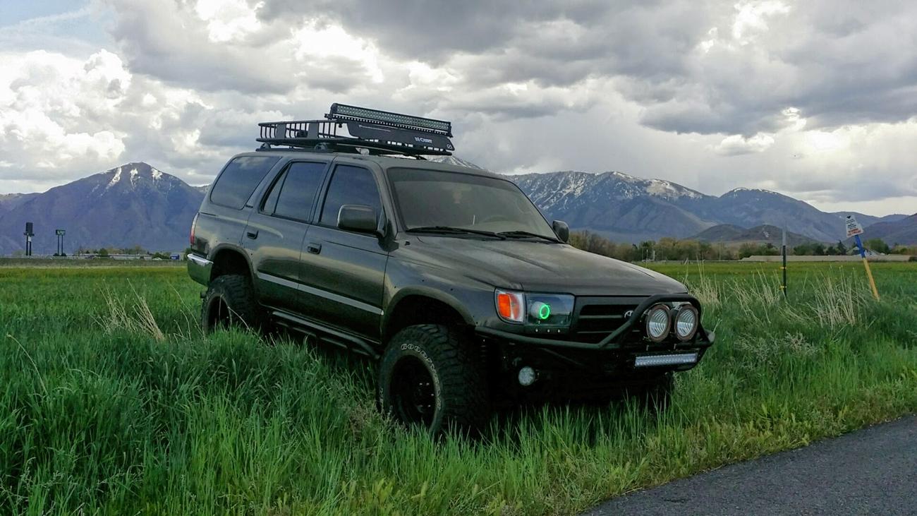

Bought my Anthracite 1998 Limited 4wd V6 4runner in the beginning of 2015 with just under 230k from one of my good friends that had owned it for just over a year.
He didn't do much to it in the year he owned it with exception of the curt basket and light bar. He also re-did the blinkers with the amber eagle-eye LED lights in the blank plate under the headlight housing.
How it sat the day I bought it!
Front- Procomp Shocks OME881 springs
Rear- Procomp Shocks OME890x springs
Front Addicted Offroad Tube Bumper
Addicted Offroad rock sliders
Curt Roof Basket
40" straight Amazon light bar

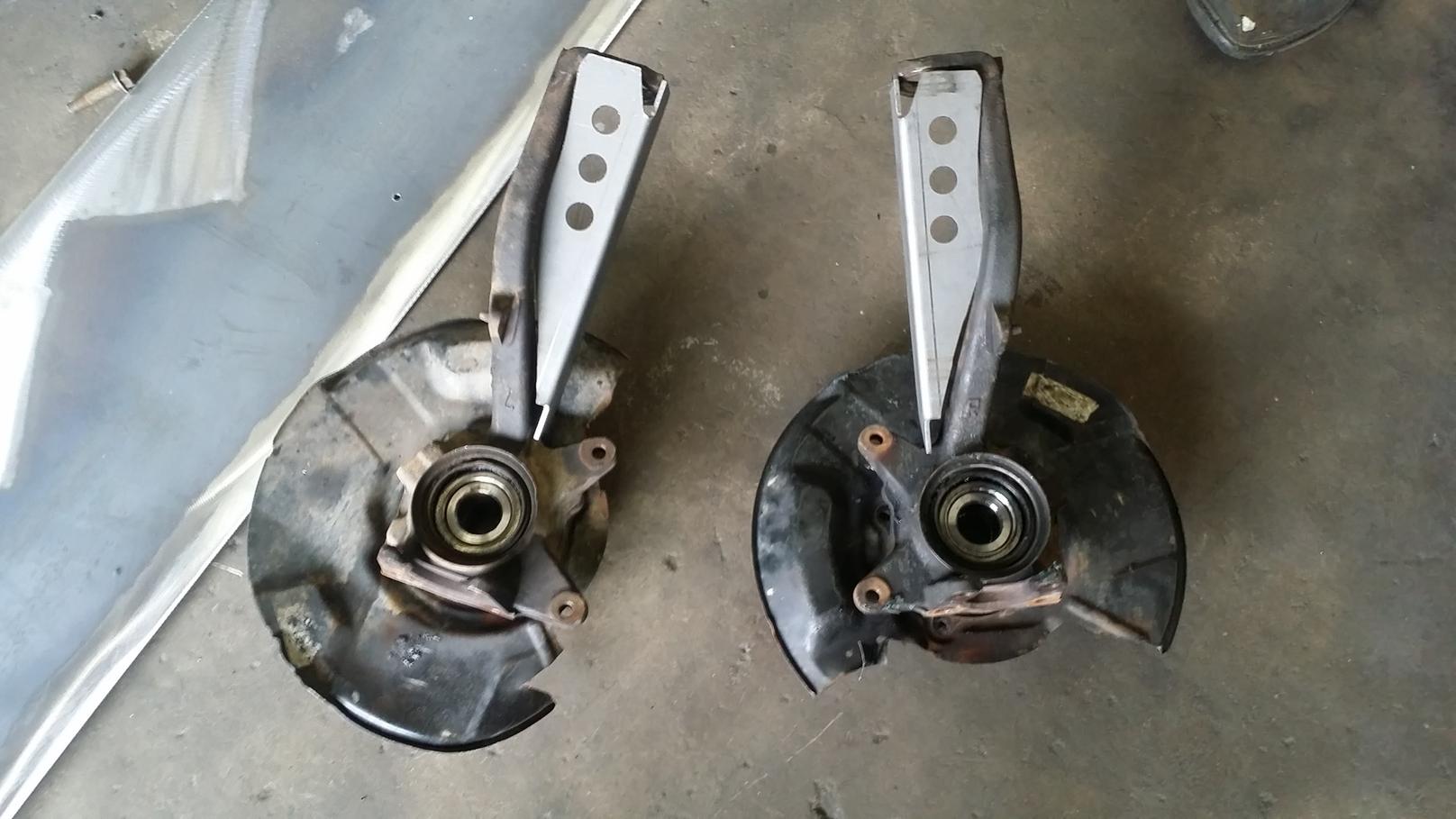

Total Chaos spindle gussets (3/2016)

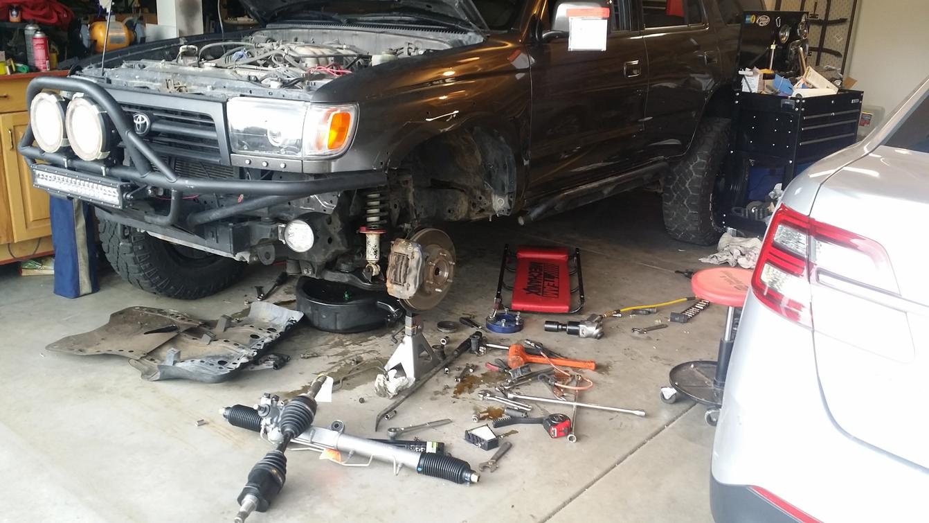

Steering rack (7/2015)
Rack bushings (7/2015)
ITR (7/2015)
OTR (7/2015)
ITR twice (3/2016)
ITR thrice (9/2016)

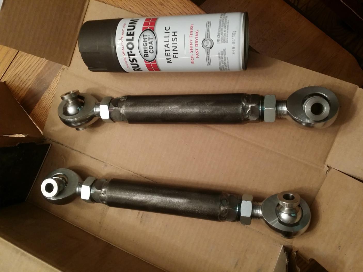

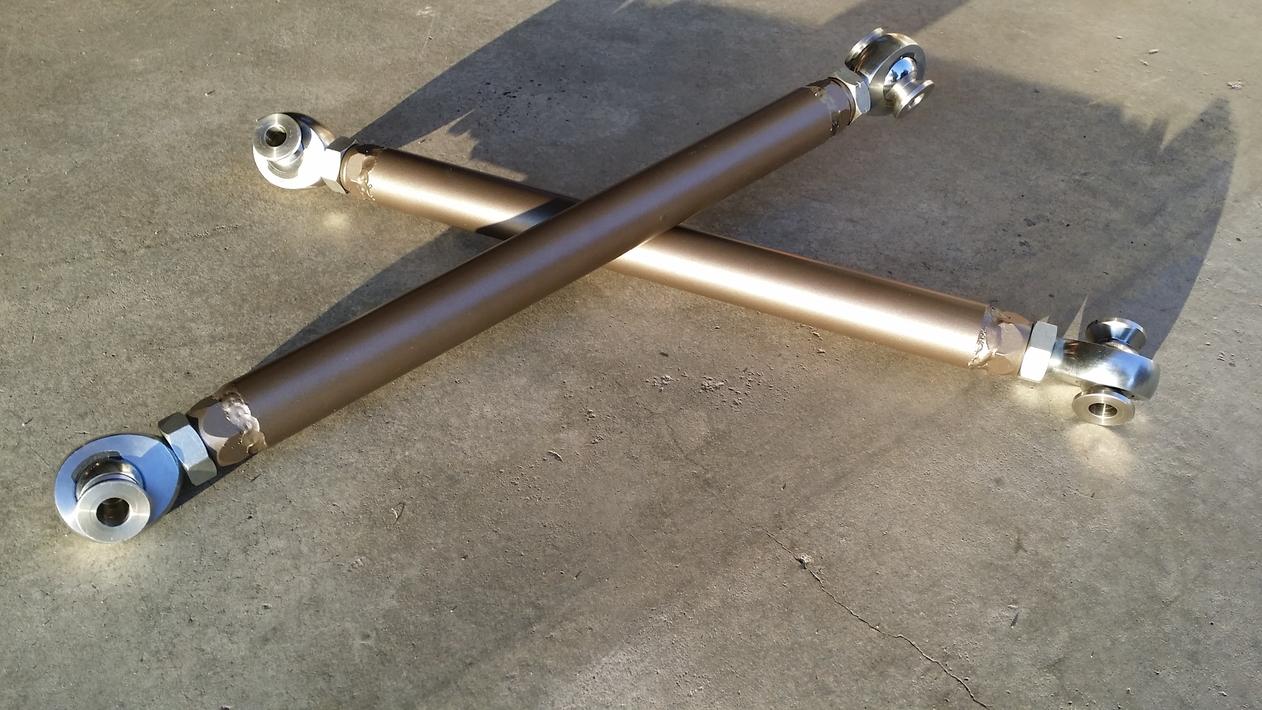

New custom D.O.M. 7/8" heim joint upper links (11/2015)
New custom D.O.M. 7/8" heium joint lower links (3/2016)

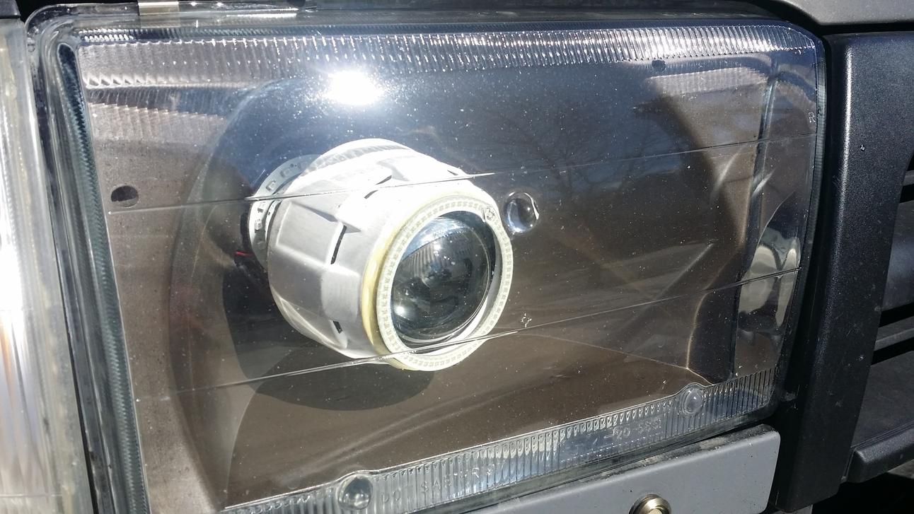

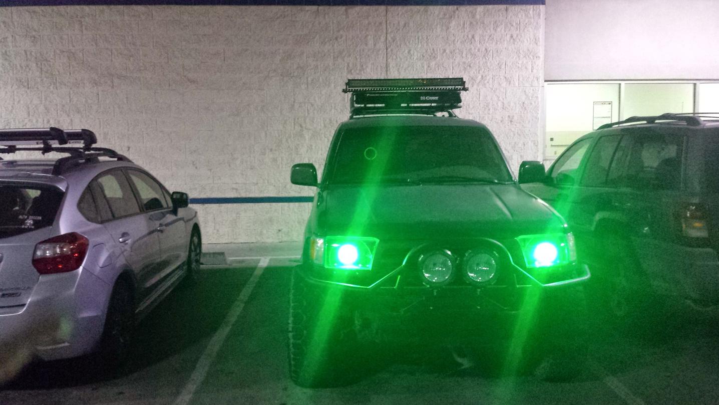

Lo/Hi beam Morimoto mini H1 projector retrofit with RGB Halo Rings (2/2015)
35w 5500k HID bulbs (2/2015)
2x 7" 55w Flood HID offroad lights (3/2015)

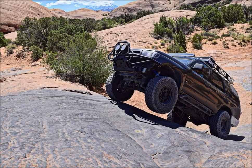

I'll take you through a picture journey of my 4runner now.

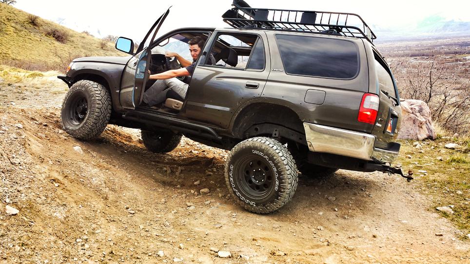

Here are a few more, lots of southern Utah trips!

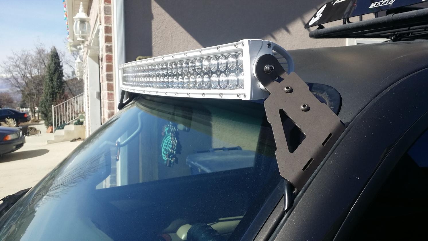

Some more adventures, new amber light bar!

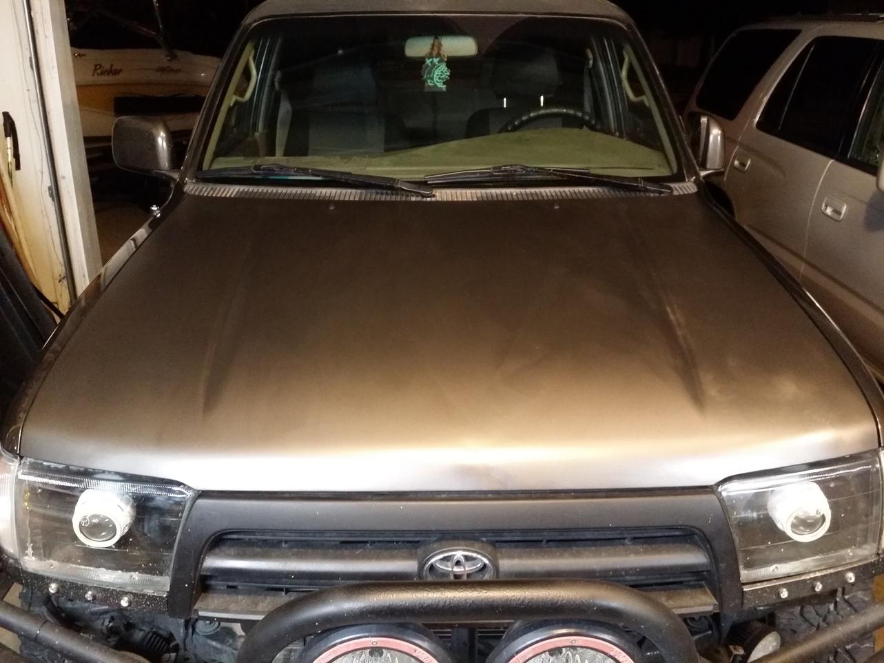

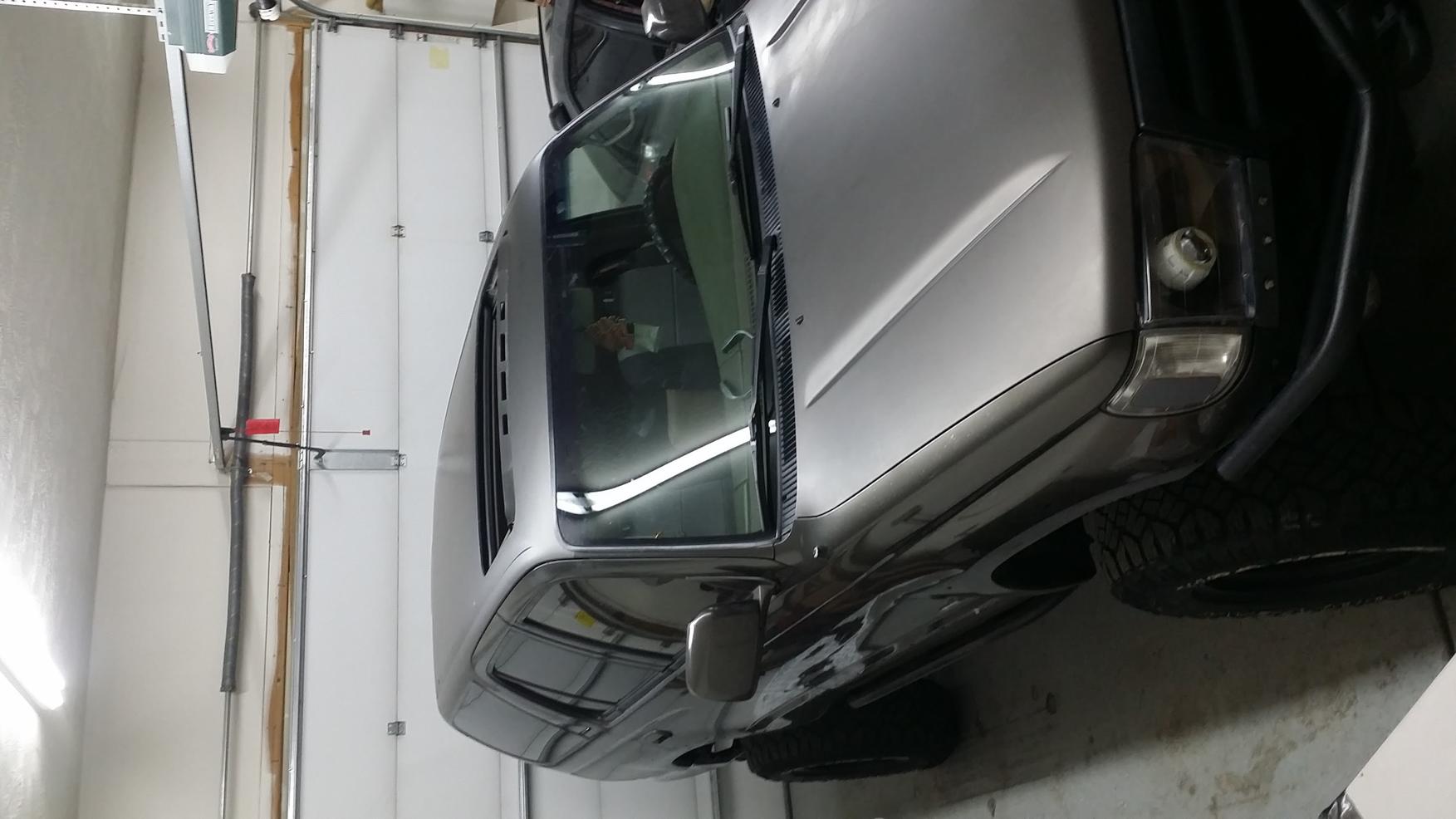

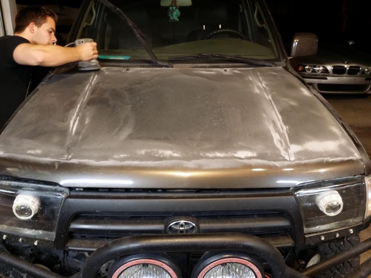

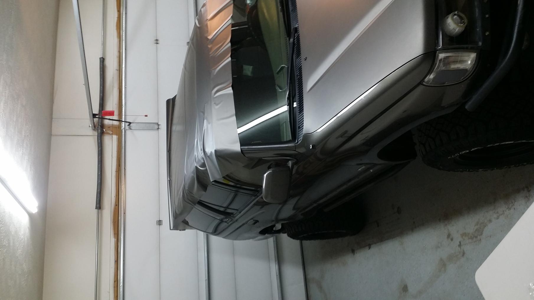

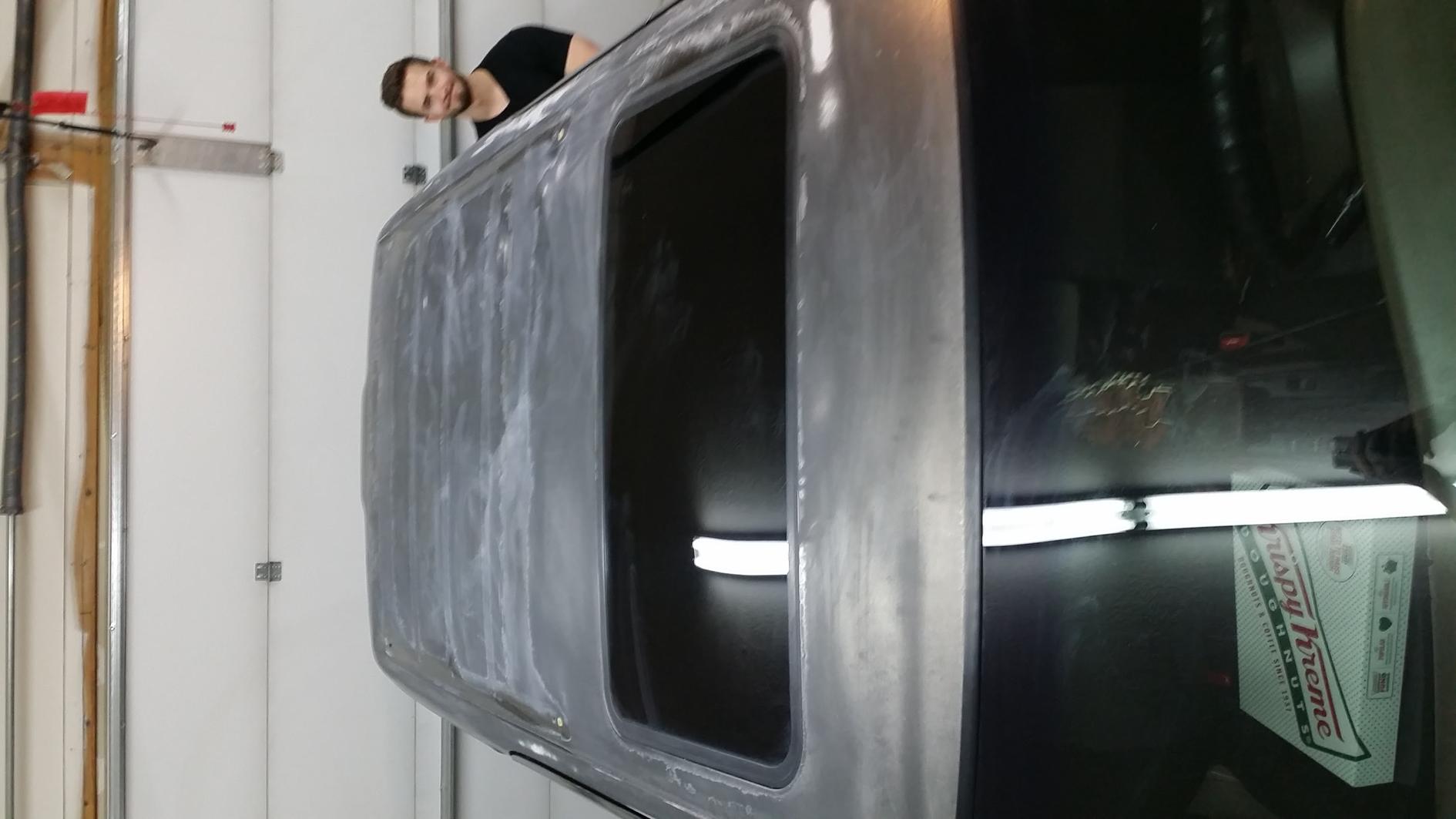

Wrapped the hood and roof in "3M M211 Matte Carbon Metallic" It is a pretty dang close match to the oem toyota Anthracite Metallic 1A1 color code
also made some DOM and 7/8" heim joint links for the rear end since my old ones were shot

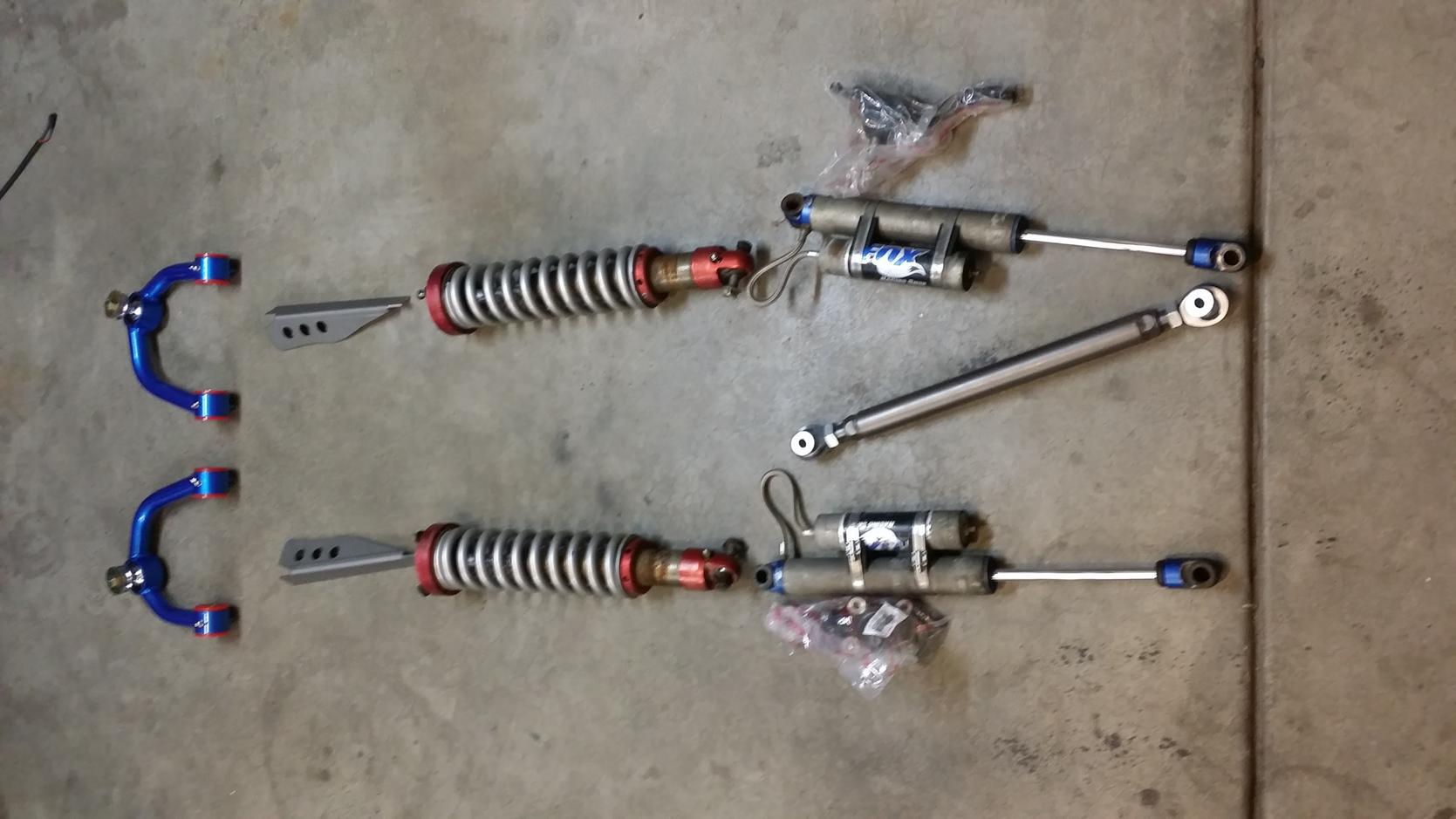

Some parts and a trip to the grand canyon

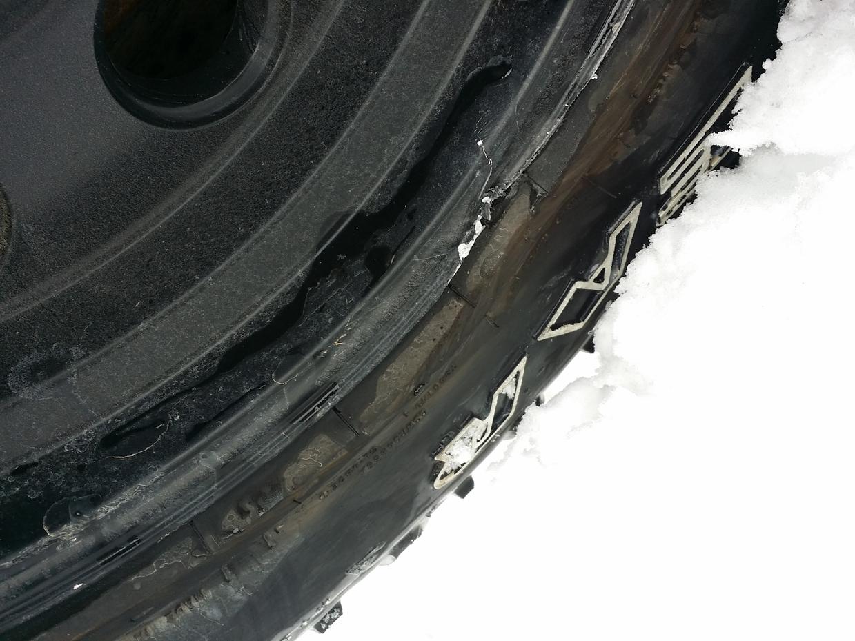

5 mile pass (offroad area about 45 min from SLC) I craked my wheel.

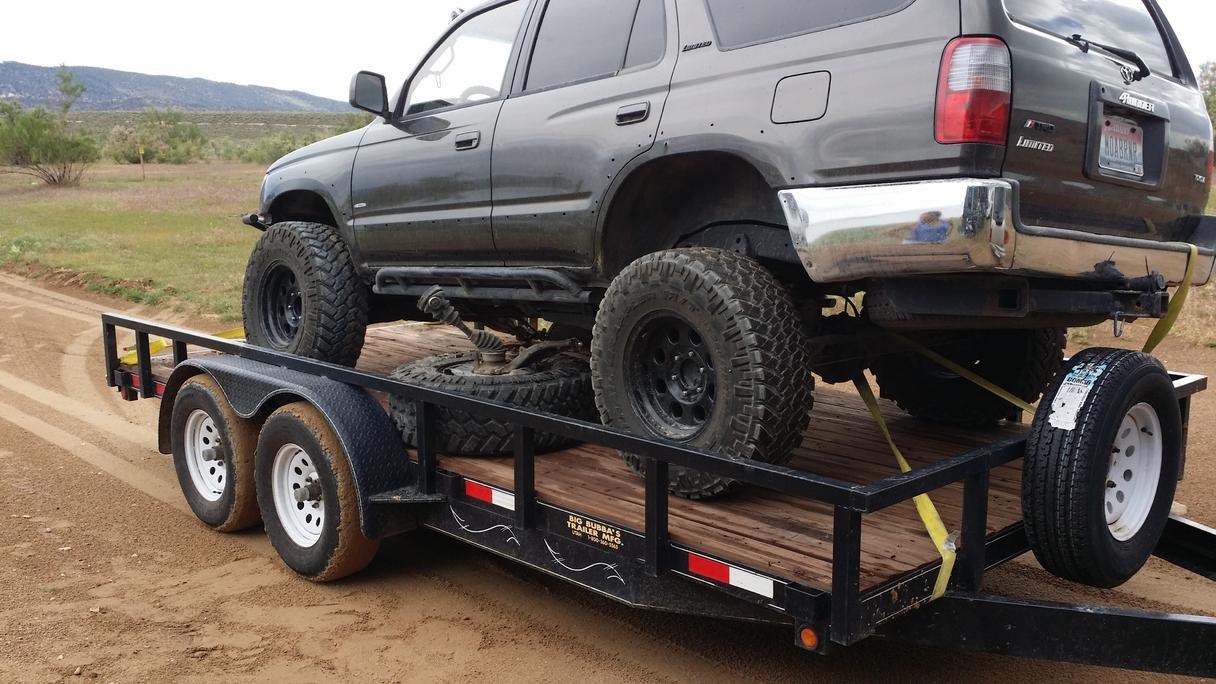

Just a few days later up at Flaming gorge I had a preventable LBJ failure, I had brand new OEM toyota LBJs but I didn't replace the bolts or use loctite. I would advise doing both of those.

What caused the wheel to crack?
