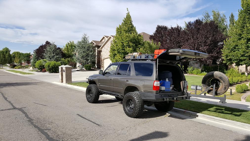

Few weeks went by on the rebuilding process, new cv, new LBJ, new LBJ bolts with blue loctite torqued to 59 ft. lbs., new camburg uniball, new tie rod and a ton of work and she was finally road worthy enough to take on another trip!
Skyline drive was the destination, here in Utah.
Very awesome trail system!
Oh yeah, I also go a new swingout bumper! :first:

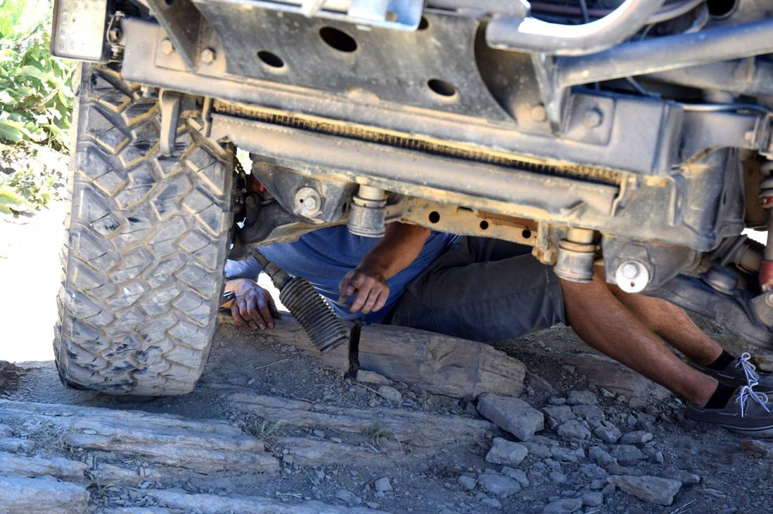

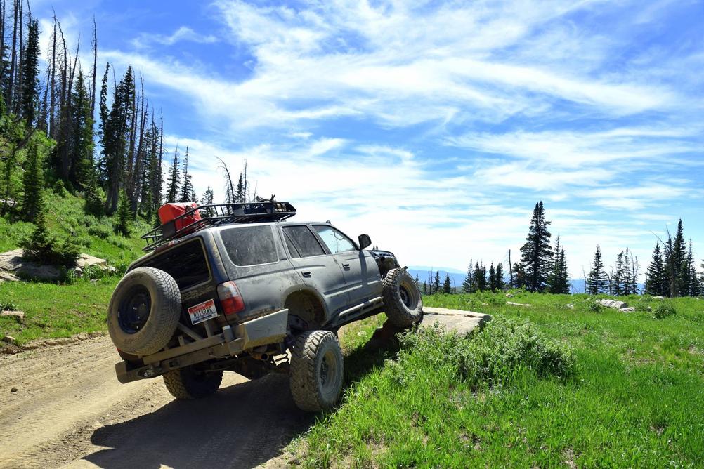

Damn inner tie rod didnt get quite the ammount of ummffss it needed, so it decided to come unthreaded while climbing up a 30 degree incline up the side of a mountain.
Oh well, you live and learn!
