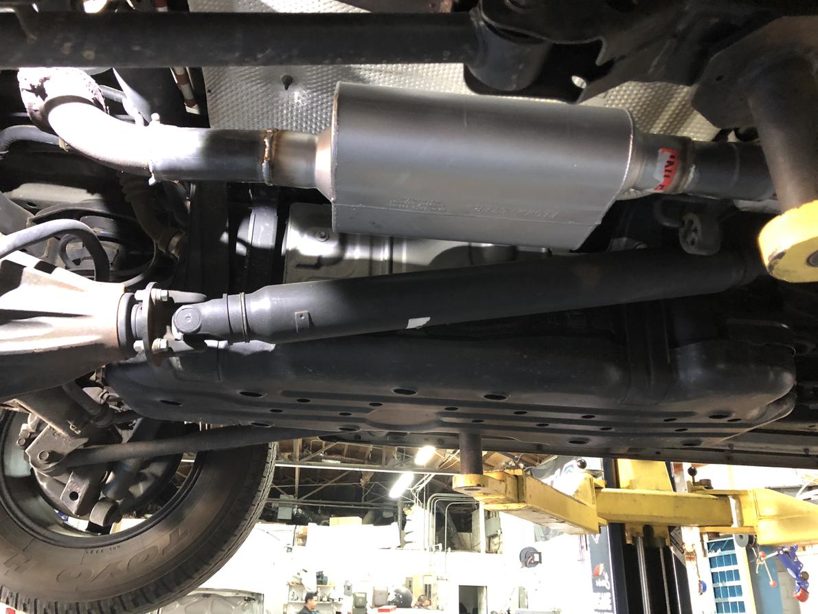

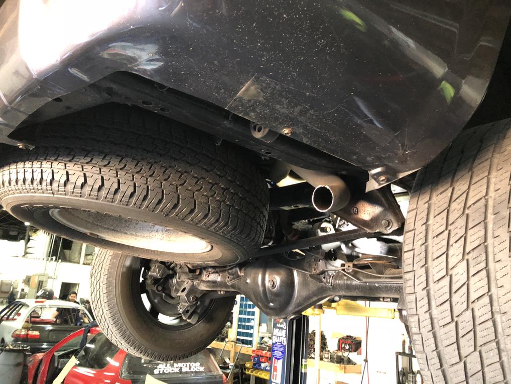

Flowmaster muffler installed and resonator deleted!
Here are a couple pictures during the install. I’ll get a few more pictures of the side exit (not shown in the images yet)when I get the chance. Still deciding if I will do a exhaust tip. This sounds great! I’ll take video of the exhaust note also. There is a slight drone at 1500 rpm but nothing unbearable.
