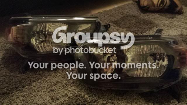

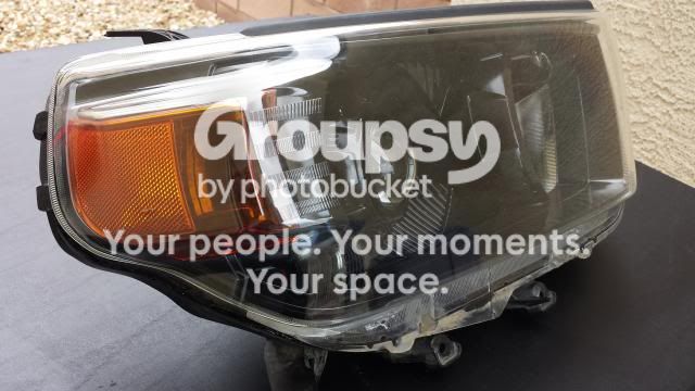

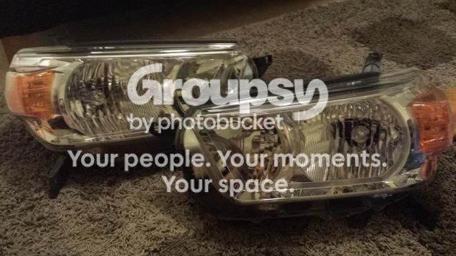

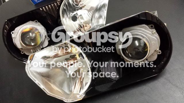

When I first got them from mikey...

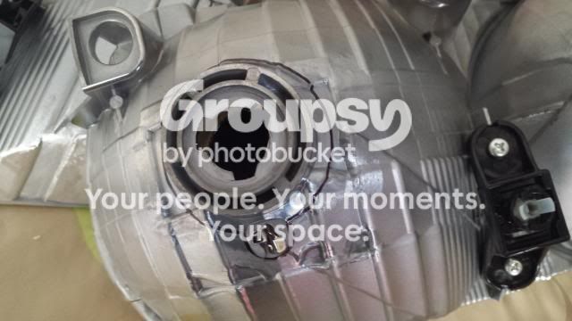

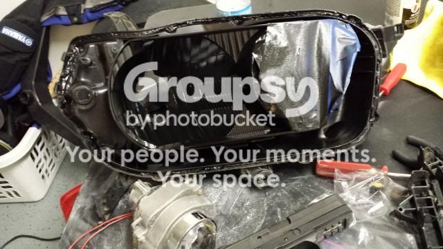

After blacking out the housings...

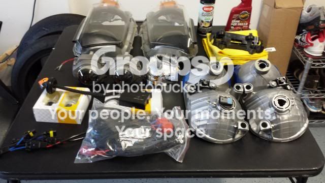

And the goods...
This was my outline for the cut. I cut a larger portion out where the where the reflector cap is. you can see it in the second picture.

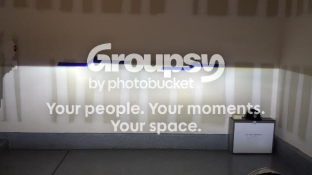

Aiming the projectors was probably the most difficult part of the entire project...

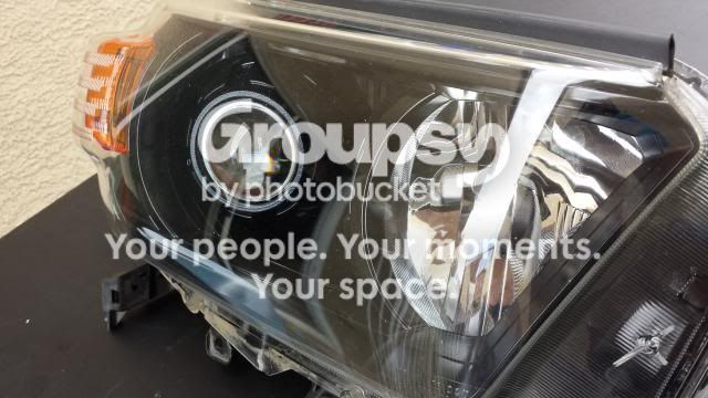

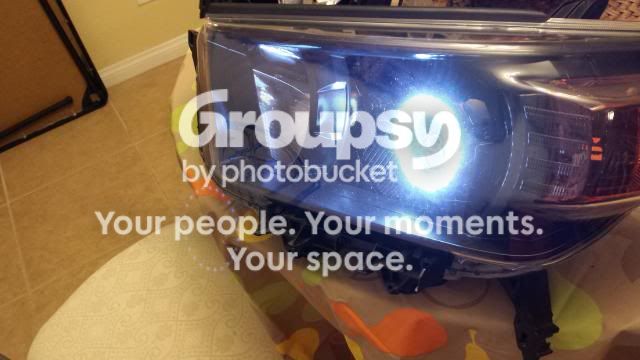

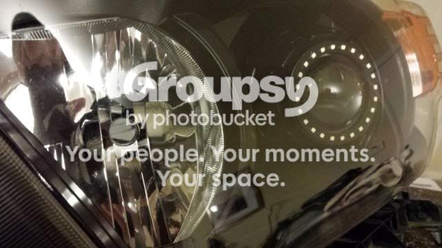

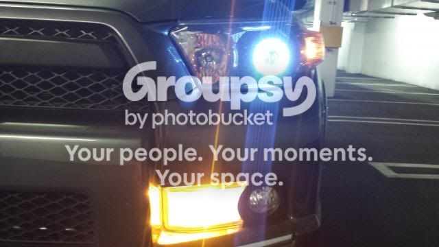

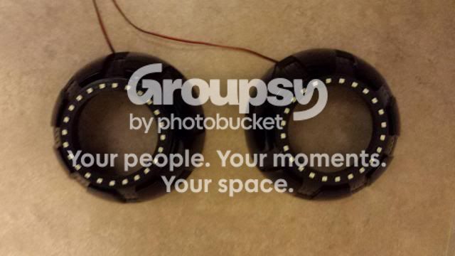

My LED halo's came in yesterday so I was finally able to finish the project and seal up the headlights. I'm going to wire them off a relay so they're only on when the headlights are off.
With the led's lit up. They are more white than what the picture shows.
And the final product...

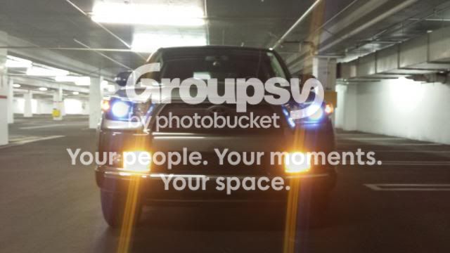

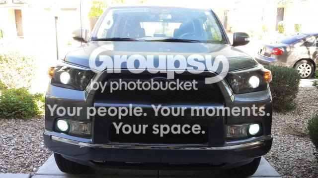

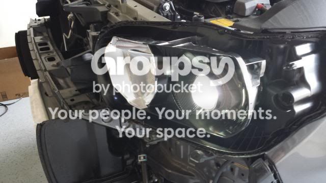

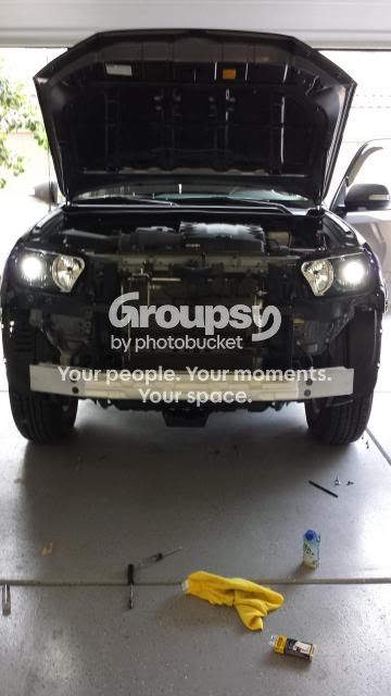

and they're finally installed!!!! I had to tweak the headlight a little bit because I was slightly off on aiming the projector but otherwise i'm pretty satisfied with the outcome of the retrofit. i haven't tried them out at night yet since there is a ton of light out but i'm sure they'll be fine. i wired the halo relay incorrectly so i'll need to redo that as well.
w/ low beams and foglights on

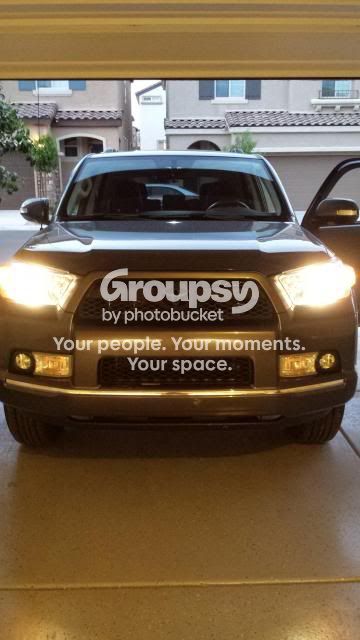

more natural light

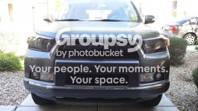

my fiance wasn't to happy when she saw the new headlights. but as soon as she saw them at night she quickly changed her mind. i was able to get some day pics of the halo's. i have them wired to a relay so they only only come on when the car is on and automatically shut off when the headlights turn on. i apologize for the crap cell phone pics. i'll be purchasing a SLR soon before my baby boy is born.
i had made a little mistake when aiming the passenger side projector and now i'm kicking myself in the behind now. the cutoff is still slightly off after a couple days of adjusting. :redbrick:
i really don't feel like baking the headlights to try to adjust anything since everything is sealed up. i'm just going to sell these and start over again. i'll post a f/s thread with all the details.
