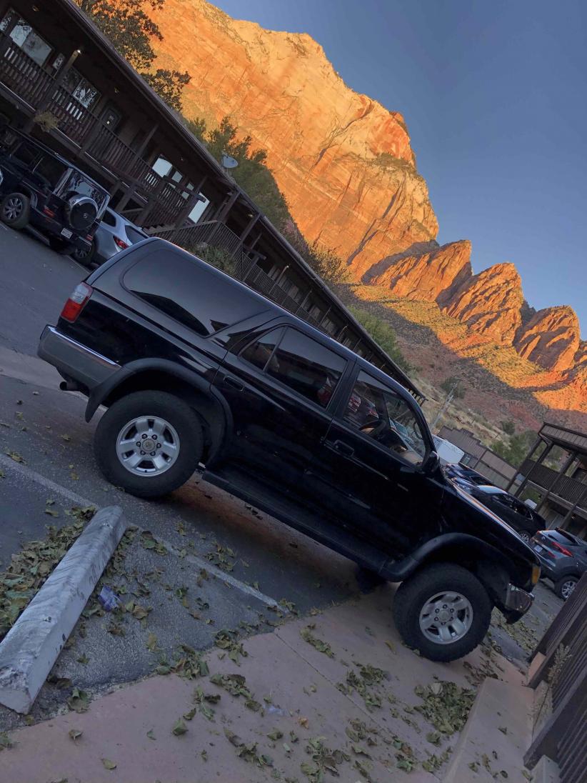

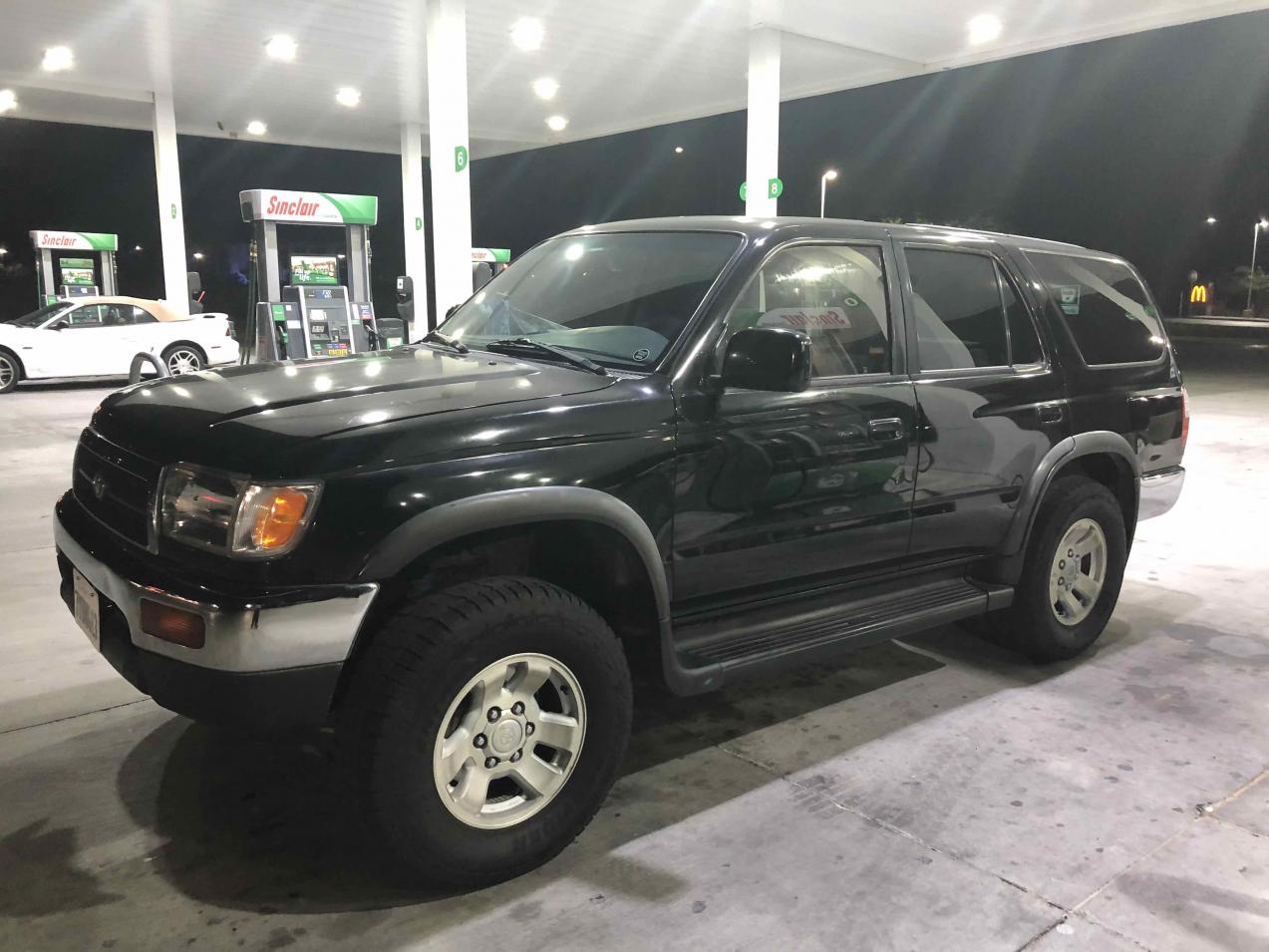

I just dropped 4k on a 1997 SR5 3.4L 4x4. The clock said 130,000 and the cheap vin report I ran (through offerup) didnt show any mileage. I didnt even know carfax logged mileage. Thought it was just for accidents. LIVE AND LEARN right?
Anyways I'm invested now. It shows the car was maintained by toyota until 250k and there is zero rust, Thats good news at least.
Timing belt, and water pump replaced at 200k (the timing belt looks good still) but thinking it should be replaced again.
Throttle body serviced at 230k
Engine and power train checked at 260k
But the bad news is the car has roughly 300k now.
I replaced the starter 2 weeks ago and plan to change the plugs tomorrow but I'm not too mechanically inclined so I'm not sure where to start, or how to tell what needs replacing. The motor runs smooth, but transmission is starting to clank after I start moving from a stop, which I read is common on the forum. It just started this after my 1,000 mile Utah trip last week.
I was going to install the 6112 coilovers this weekend but not sure if thats a smart move. I may need to save the money for something big in the future.
I cant sell the car knowing the miles were rolled back, so I think its best to dump money into it and enjoy the ride.
What do you think? Should i start doing preventative maintenance or will I know when shit starts happening it needs to be fixed?
