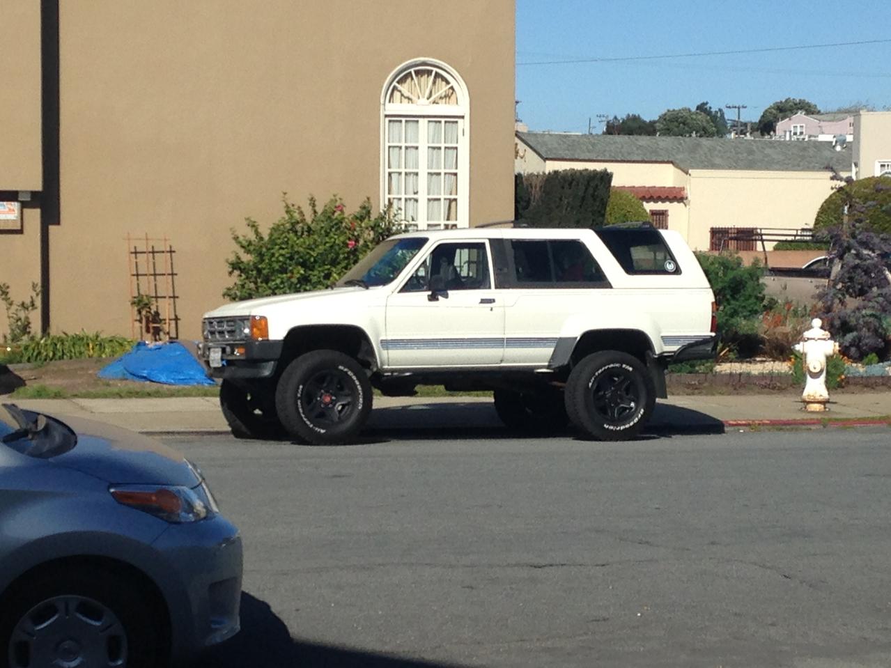

I was in the same boat as you, didnt want to make my truck a crawler, just a weekend warrior. I did a 2.5 inch lift with the spacers and have no rubbing issues with bfg 32's.it was a pain in the ass getting those spacers in so be prepared with a grinder. rides great now!
