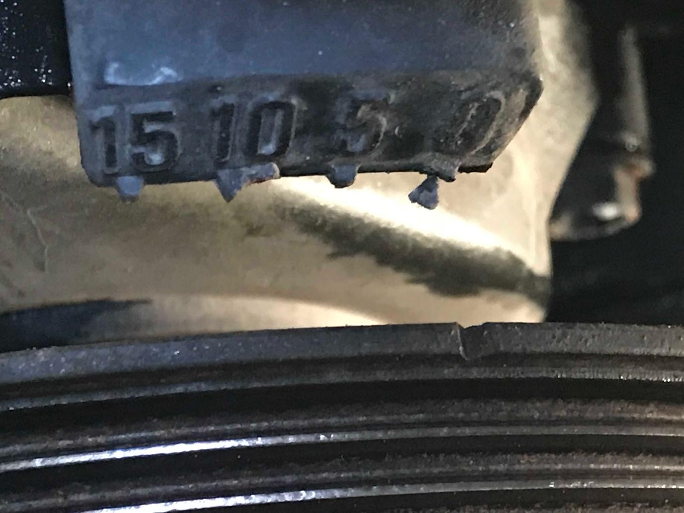

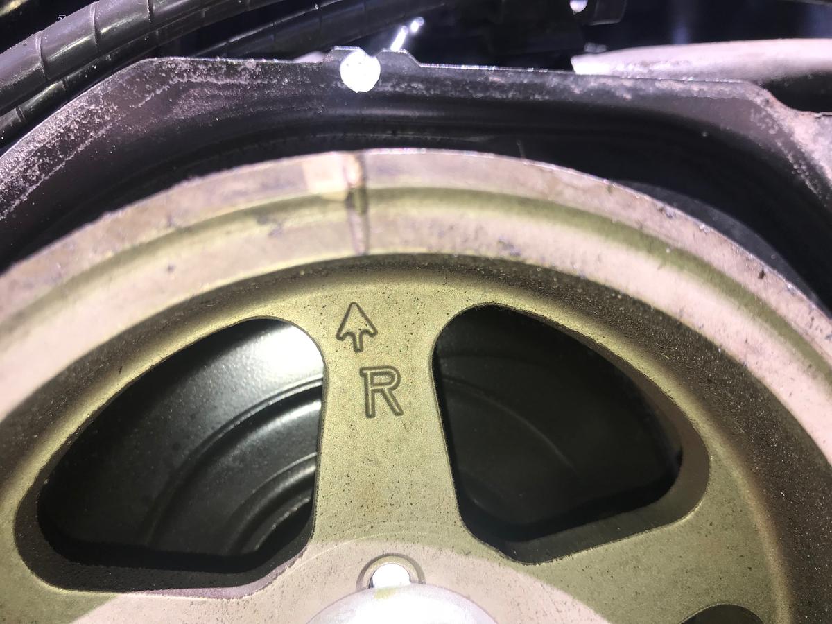

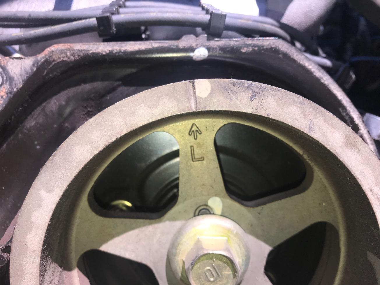

So today I removed the timing belt cover and lined up the crank and cam marks - looked close but I thought the cams were both slightly behind the crank I thought.
I moved the crank pulley a bit counter-clockwise and noticed that this time the cam pulleys didn't move! Moved it again clockwise and sure enough no movement until I moved probably 5 degrees...
