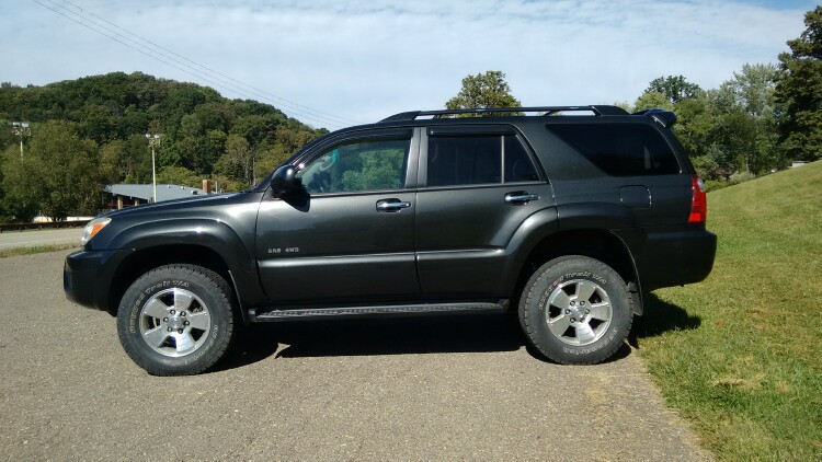

I paired 883's with my T12's and the rake is perfect.
I have Bilstein 5100’s already in my possession and really want to avoid using the perches...also will not use stock springs cause mine are sagged out
Understand. Do you want to end up with 2ish inches or 3inches of lift? Get 883's if you don't want to go that high. Or taller rear springs (icon, toytec) to raise the rear.
