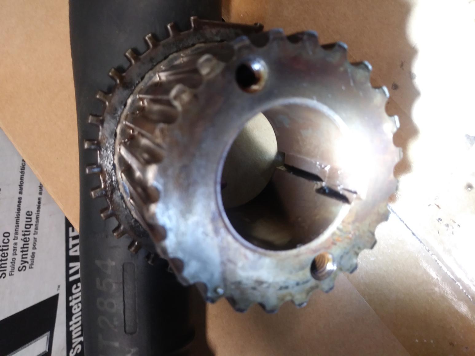

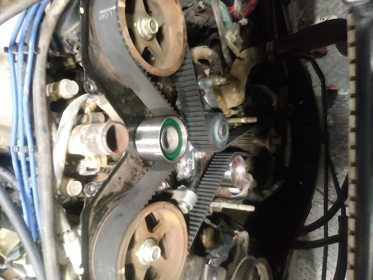

Finally fixed it guys.my crank sprocket was f**kd up! Crank bolt was loose i guess last guy in there didnt tighten it enough. The sprocket was able to move and it ate it up. So new timing belt kit crank sproket and crank key way.now she runs awesome way more power starts right up no rich smell from exhaust! I finally found it! Thanks for all your help guys.

Yeah thats no joke. I found alot of loose bolts in there and it makes me want to go over every bolt on the truck now! I already checked all the suspension bolts when i did my ball joins and lift. But i want to go over it all now
