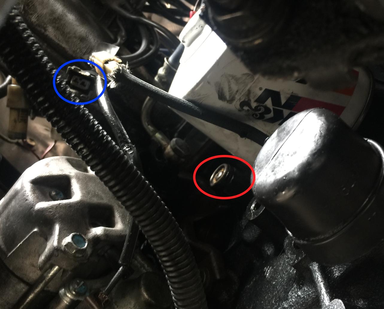

Alright, I feel like an idiot. What I pulled out thinking it was the knock sensor was actually the oil pressure sender unit. :rtfm:
I searched a little deeper and I think I found what should be the knock sensor.. but looks like the previous owner just plugged it with a screw.
Also I noticed a connector that's not connected to anything. Wondering if I need to figure that out.. of if that's the connector I need to plug in when I find a new knock sensor. I didn't check if it has 1 or 2 cables in it.. but obviously it has 2 plugs.
