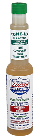

Several months ago we srarted noticing a rough engine for a few seconds after startup. Our mechanic said it has something to do with the fuel injectors and cooler weather. Recommended us to add some Lucas Oil additive every few tanks of gas. So we just added one bottle a month. Problem seems to have gone away after a few months.

The Lucas Oil Fuel Additive does clean the fuel injectors and also lubricates them. Time will tell if that is the problem or if it is the beginning of the head gasket ordeal.
