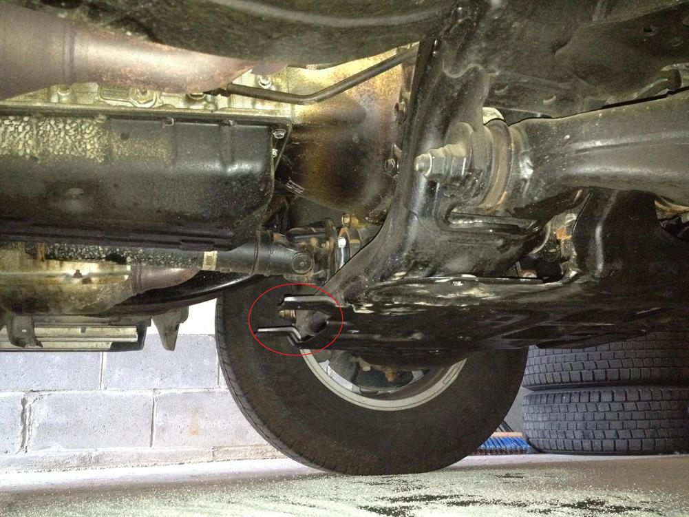

Can someone tell me if something is missing? It looks like something should be installed on the brackets that I circled in red.
This pic was taken from the passenger side, just behind the front tire. Could someone take a pic so I could compare?
It's a 2011 SR5 upgrade package.
Thanks!

Plastic splash guard! It only comes on Limiteds and does very little if anything.
It's been discussed several times.

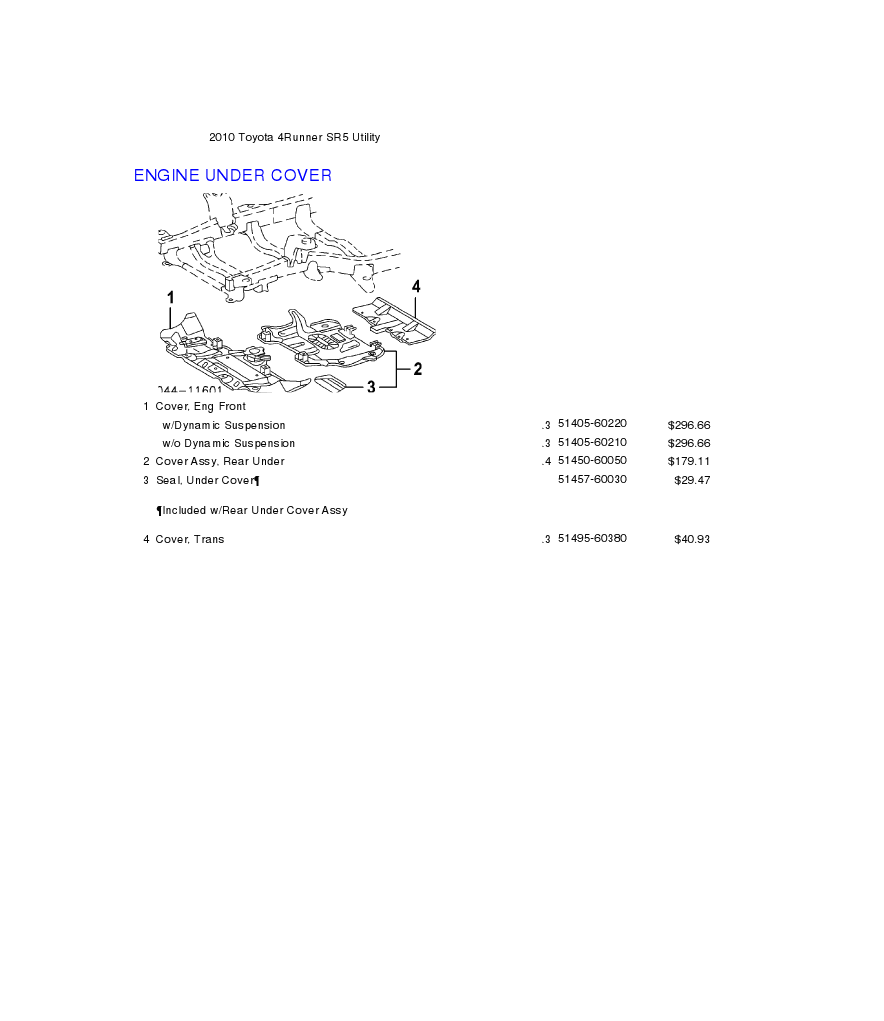

#4 Part Number
cover ,trans 51495-60380

Phew!!!
Other thing I noticed in the pic is why my tranny is black at the bottom... I'm hoping it's the Toyota under coating??
