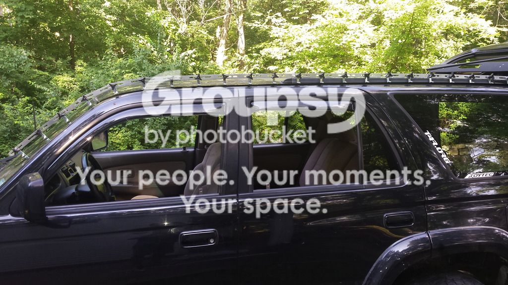

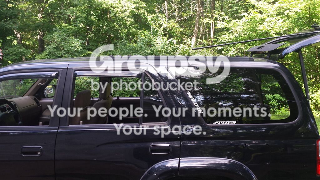

I decided to go ahead and start the roof rack today. I had a lot of other things going on as well. So I didn't get nearly as much done as I thought I would have. It's still at start though. I'm going to start with a 3/4 rack, and then have an add-on section to convert it to a full length rack.
Off with the Yakima.

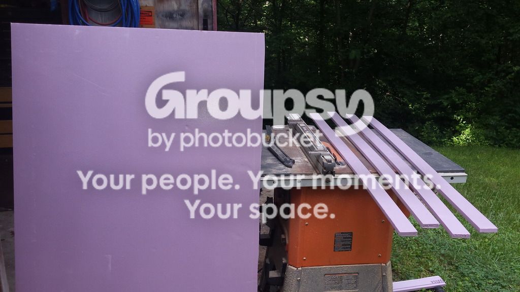

Next was cutting some foam down to size.
20150725_171425_zpsunpzowis.jpg~original

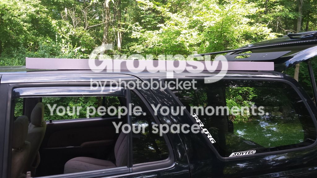

The foam needs to be trimmed to huge the roof line.
20150725_171508_zpshtg59k4y.jpg~original
This is how you get a roof contour.
20150725_172020_zpsm7k8tyxp.jpg~original

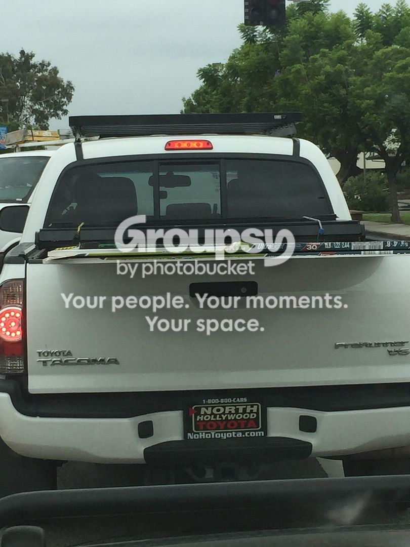

Saw this little platform on a Tacoma the other day and liked how close to the roof just needs some sides.
How will it mount? Using existing rails or Yakima style roof mounts? Can't wait to see it. Definitely looking for nice low profile.
I think it's safe to say that it'll be similar to this, but still different. Mine will be tied into the existing rails by using t-slot nuts. I think mine will hug the roof more than the one you posted. The goal is to get this as low as I can without contacting the factory rails, or the roof. I think I'll offer textured powder coating as an option too.
