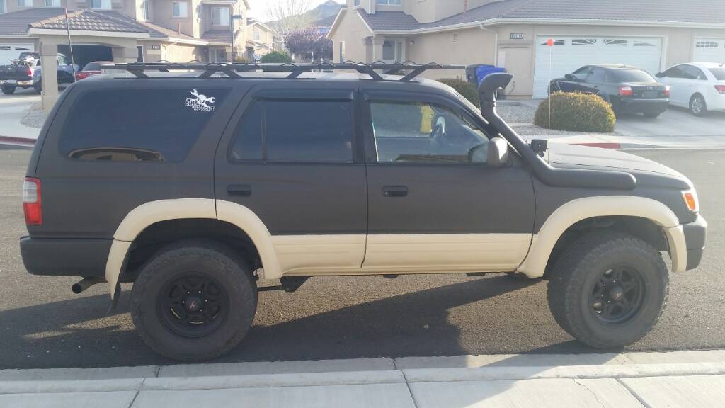

Really wish I would have had what you used to get the roof contour when I built mine. That was the very worst part of building the rack. Instead I had to fit the middle supports and then grind the outside legs till I got a gap that was acceptable to weld. Lots of checking. Ended up pretty level for garage work but still it begs the question. What is that tool called?
Here's a pic of mine.
Another completely off topic question but I'm guessing you're a machinist or in the field at least. Always like seeing what you cook up. If I didn't build my rack first I probably would have leaned towards buying yours.
It's called a Curve Template, and they come in lengths of 37" & 107". It's used more for woodworking then anything.
