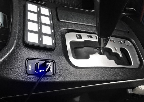

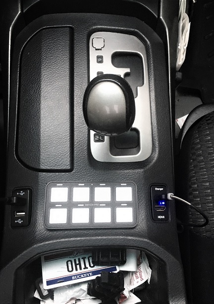

A few weeks ago i worked on mounting the SwitchPros switch panel on my center console. I was really please with the results. Leave it to @TiN to come up with an even better solution. He sent me one of his prototype mounts for the SP unit. I received the mount, backing plate, threaded rods and nuts.
Mounting couldn’t be any easier. Just pop out the three blanks in the console, put the switch in the mount with the threaded rods installed. Place the mounting plate on the underside of the console piece amd thread the nuts. It fits the contours of the console perfectly. Go check out [MENTION=29196]solid[/MENTION]shiftconcepts for some of his other cool pieces.

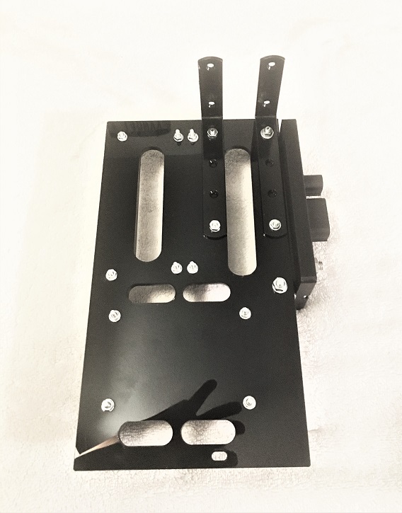

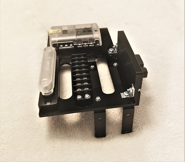

I made my own power tray in AutoCad and a laser cutter and this is what came out:

I had to modified the design a couple times, since it did not fit well when I closed the hood. Soon, I will install the power tray, and follow your instructions to pass the wires through the firewall into the cabin. I'll post a few pictures once is installed
