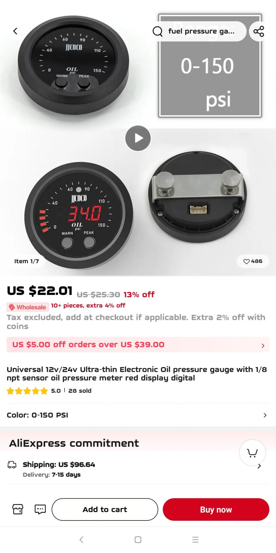

Slim Oil Pressure Gauge
Hi, i dont think 3rd gen 4Runners having oil pressure measuring how much pressure engine has. for that im installing a slim oil pressure gauges from AliExpress. to keep using the factory one as well you will need to have an adapter to accommodate both sending units.
