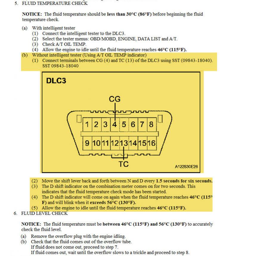

I also used my OBD reader to verify temp. But theres also this method:

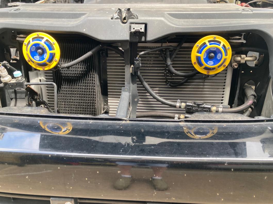

Im running the B&M 70264 11x6x1.5”. 14,400 BTU cooler plus the Derale 25791 thermostat. The temp runs about 130* Normally and 165* towing no matter how hot it is outside. It fits nicely in front of condenser on passenger side. . Well worth the investment.
