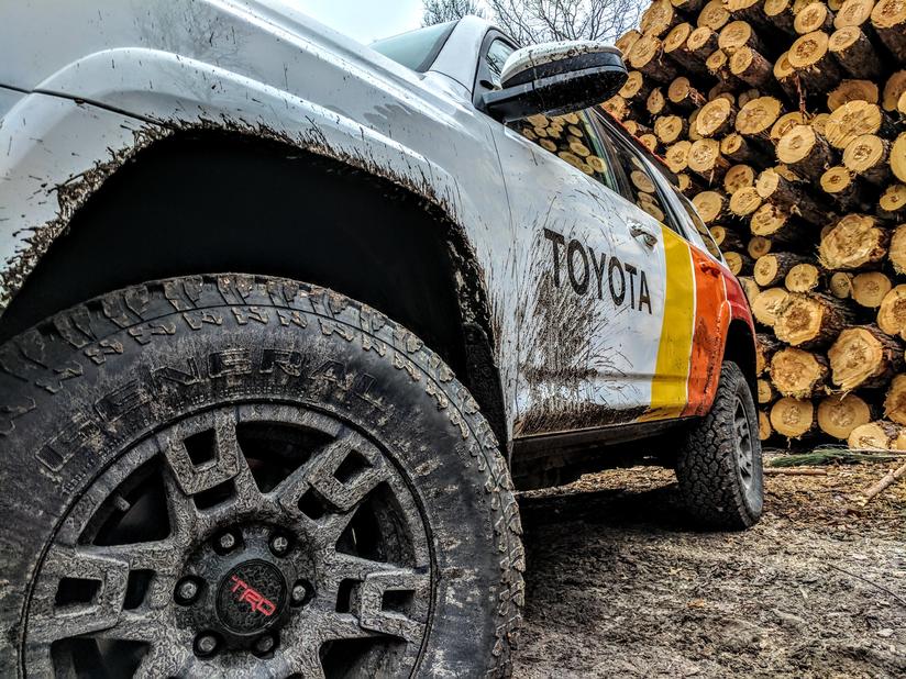

So, I have been trying to solve my future front end progress. I'm at 2.5 with Bilstiens and stock coils at the moment. (my alignment is Wed. the 5th)
I know I am pushing stock adjustment and will be interested what my local Toyota has to say and do with my alignment.
but in the near future I plan on doing a winch and a smaller bumper (like Southern or C4's) and I have some coils in mind (OME or those teal ones )...but that naturally brings me to UCA's.
Can anyone explain if there is any benefits to running Moog style ball joints?
I live in the shittiest place for vehicles (MINNESOTA) Home of all extremes and the 4 letter word "SALT" . This 4runner get driven alot (already 80k miles) and see plenty of offroad!
any advise would be appreciated!
