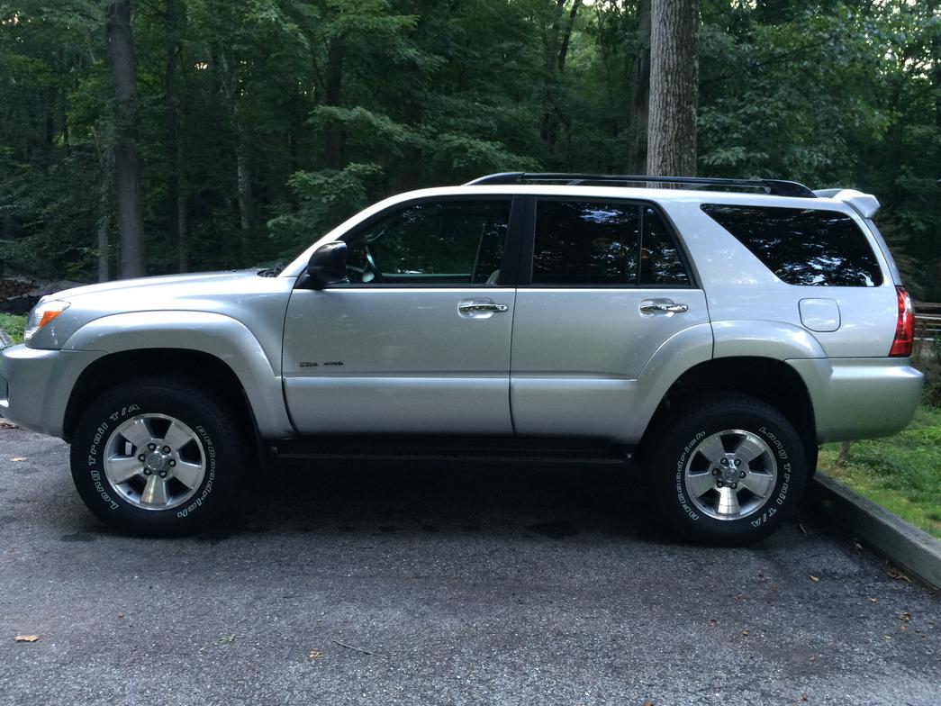

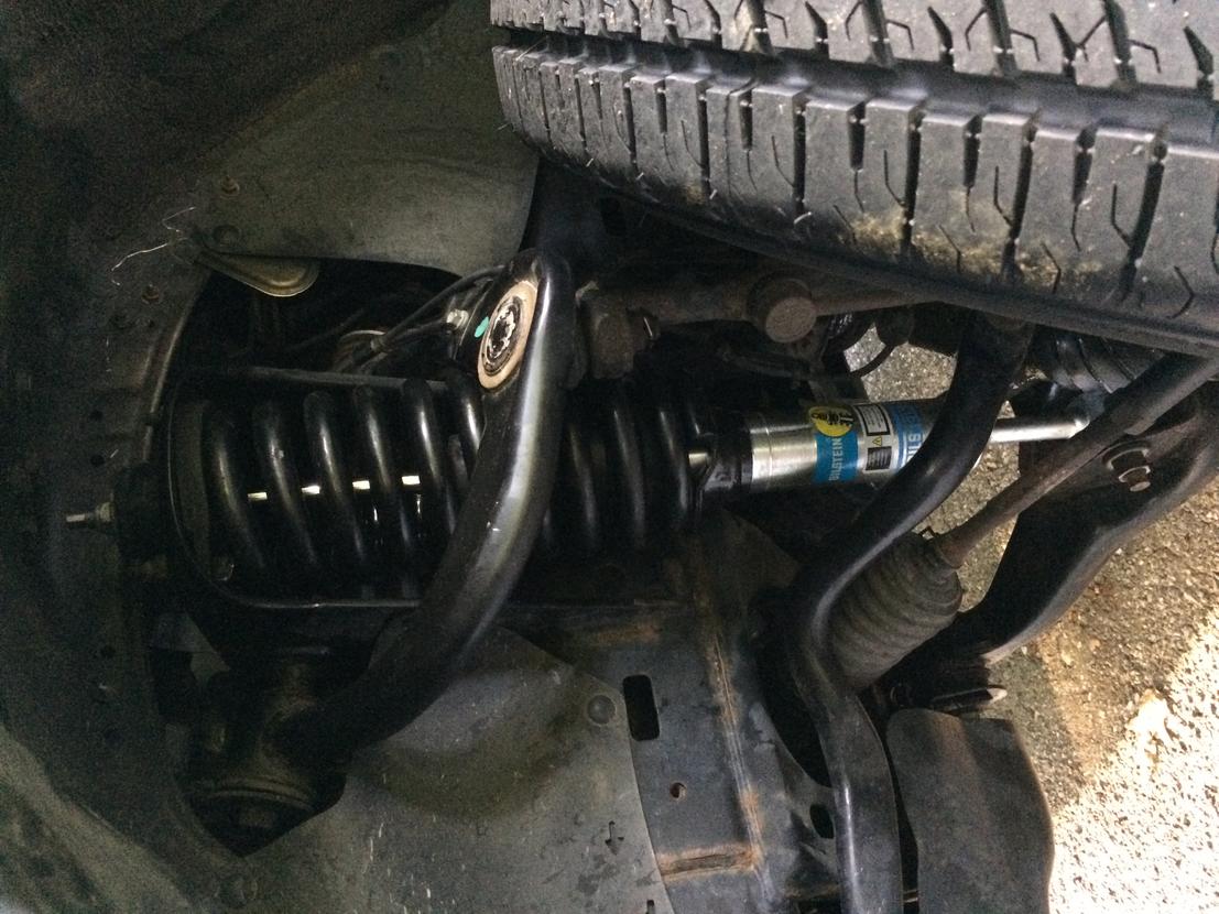

Here are some shots

Photo of truck
This has the Moog springs FJ 2008 4wd replacement. 5100 all around with fronts set on 0.85. No spacers. Tires are 265/70r17. Do have spider 1.5" spacers.

The Bilstein spring bucket is installed wrong. It is upside down.
It sure is. That's what I suggested might be the problem in our PMs except I just said the coil wasn't sitting down in it correctly. I can see why one might make that mistake though
Yep, upside down. I'd get that fixed before I drove on it anymore. I saw on the tundra forum driving with this condition led to the front shocks collapsing. With the spring seat in the correct position, you'll see that it completely encloses the snap ring, thus keeping it from popping out of whichever height setting you chose. I don't know how many people had a similar kind of failure, but just making you aware of the potential risk. Good luck....

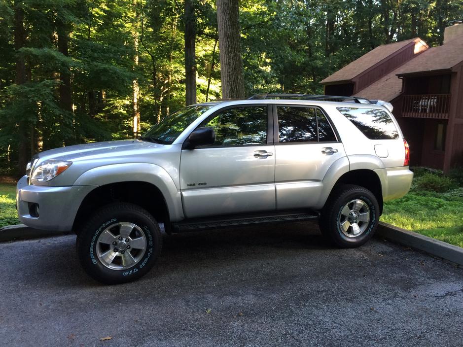

All fixed. Now to have the alignment done again! Love how it came out. If it settles over time, I do have a Daystar 1.5 for the back, but was worried that would be too high.

Sure does look puuurdy now! :)
Yea, this forum is pretty awesome! It's almost like I know what I'm doing... :/
That looks great. Glad it was an "easy" fix for you.

I thought the original install looked kinda sketchy. I was a bit uncomfortable that snap ring could hold all that load. Seeing a cup helps hold the ring closed makes me feel much better than before where it was just an exposed ring! :frusty:
