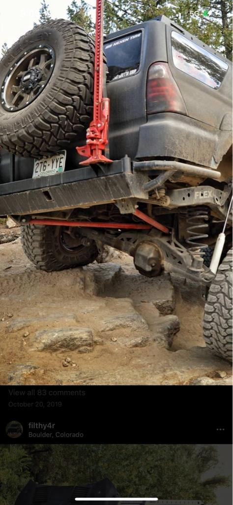

Not really great flex pics, grabbed them from some video.....I am really really bad at remembering to take pics/vids when we go out...

Just going longer travel shock is only going to get you part way there. If you’re running factory links in the rear they will bind before you get full benefit of a long travel setup.
If you REALLY want a lot of travel you can go 3link or reverse triangulated 4 link with super long links and then you’ll really have long travel in the rear
