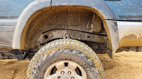

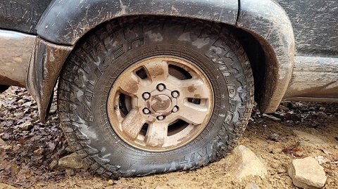

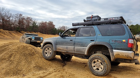

The photos below show what I am getting at full droop/Full compression. Is this too little or seems to be about the right amount rear travel? Stock swaybars connected in all photos/no extended bumpstops. Tires are 265/75s

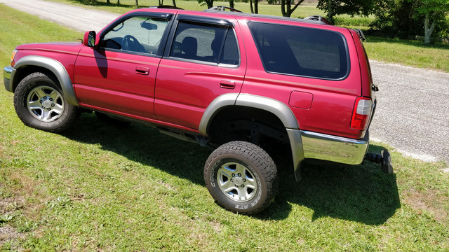

Could you post a photo of you flexing out your 890s? I want to compare it to mine?

I don't recall if this was maximum droop, but it's probably close:

The correct way to pick shocks for your coil is to flex one side of the rear axle up toward the body until you either reach your bump stop (ideal) or the tire hits the wheel well (not ideal) and take a measurement. That is your max collapsed shock length. Try to find a shock with a collapsed length shorter than that. Then droop the axle away from the body watching carefully to make sure you aren't going to stretch a brake line too much or damage any other components or lose your rear coil spring. Once you have reached your max droop take another measurement. That is the max extended length you want.

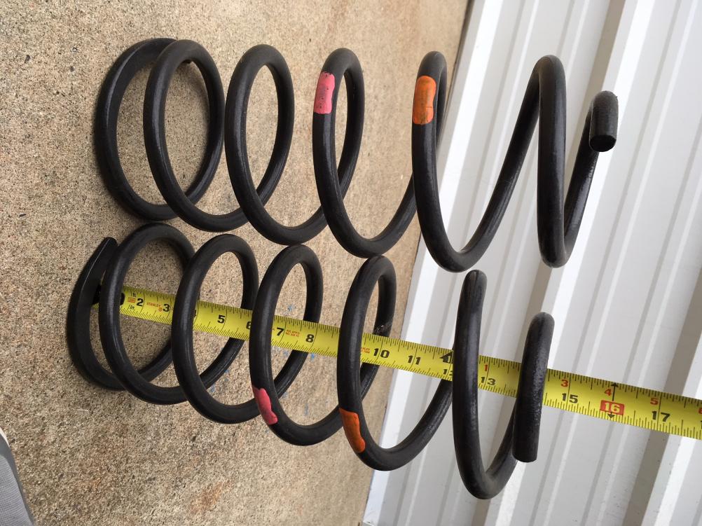

So after doing some research a stock spring for a 4th gen is 14 something inches free height. My 890s measured almost 18 inches free height. OME 895 which lifts a 4th gen 2 inches is saying that its free height is roughly 15 inches with a 17mm bar diameter. So does this mean those "long travel" shocks will fit? Seeing as it's now trying to hold an almost 18 inch long spring instead of a 15 inch one it should theoretically keep it in place? I follow someone on Instagram who runs those shocks with the toytec 3 inch springs. No idea what supporting mods but they do work. Any thoughts?
I agree. When I first got one I never expected the lift options to be 3 inches as a minimum or attempt to mix and match. I'm going to do some research and see how long stock 4th gen coils are. If they aren't too long then ill pull the trigger on some 4th gen shocks and extended swaybars
Just as a reference this is the stock 5th. gen. rear springs out of my 17 SR5. Sorry i meant springs.lol

Ill have to try this. I don't really live in an area where I can easily find a spot to flex out the truck but ill locate something and report back with measurements. ill have the 2nd gen sway bar links on the rear and see if that gives me the articulation I'm looking for.
Where should this measurement be taken from? I'm assuming from underside the top shock mount to the bottom mount?
Keep in mind this is what im seeing for full compression/droop(see below). This seem about right to you? stock swaybar links still attached with the 0-2 inch 4runner 5100s
