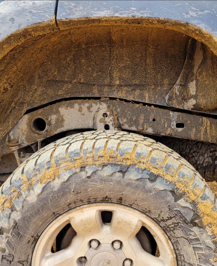

Keep in mind this is what im seeing for full compression/droop(see below). This seem about right to you? stock swaybar links still attached with the 0-2 inch 4runner 5100s
Yes, from the upper shock mount to the stud on the axle. If you have an offroad park or shop in the area they might have an RTI ramp which would be helpful. If practical I would remove both rear shocks for testing and have a competent friend drive up a ramp/ditch/rock mound/neighbor's mustang/etc while I watch for binding or the coil about to unseat.
Rear sway bar isn't really stiff enough to limit rear flex, but if you have a rear e-locker the sway bar can contact the e-locker motor/actuator.

Is this something to worry about?

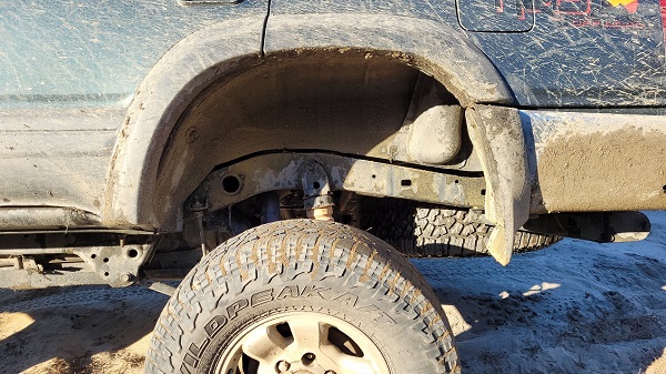

Now the part everyone has been waiting for, do the 890s fall out? The answer is a solid NO. If you ditch your swaybars it might be a different story but even when lifting a wheel they are FIRMLY in place. I did run into the gas tank/driveshaft issue but a quick cut on the skid to where it made contact and now the driveshaft doesnt even come close to hitting, again if you ditch swaybars it may still hit.
The LC shocks provide a decent amount of travel over the 5100s I had before. At least 3 or 4 inches more. Even full flexed I still have at least another 3 inches before the shock bottoms out.
The photos below show me at full flex with the 5100s(Lifiting a wheel about an inch) and the other shows me at full flex with LC shocks(also lifting a wheel about an inch) You can see the top of the tire is much further down.
