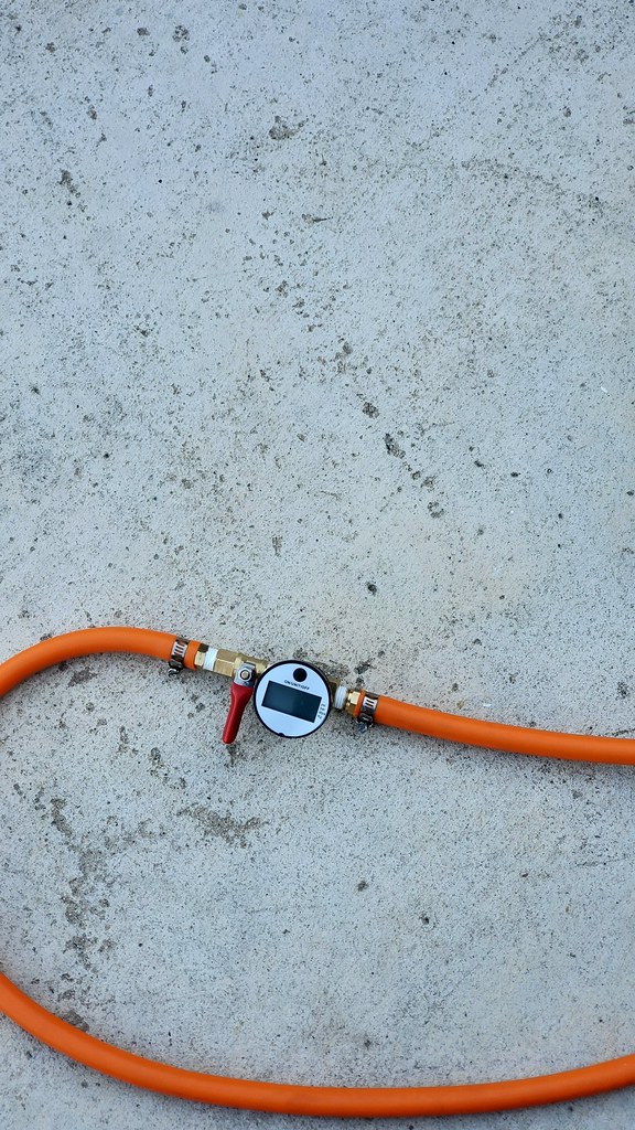

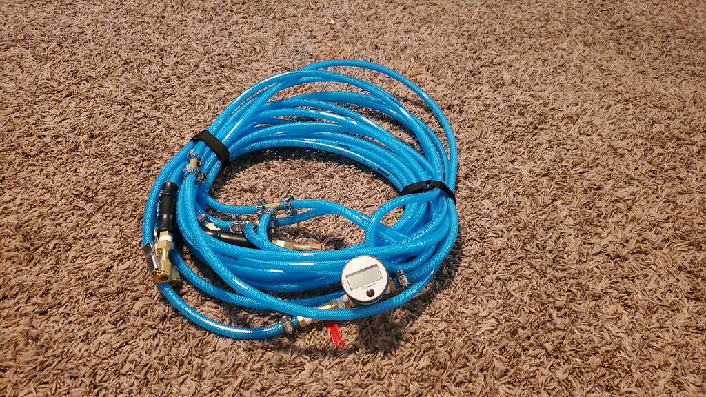

I built my own 4-tire inflator/deflator based on a few YouTube videos that’s similar to the MORRflate. Whether or not you’re a DIYer, I think it’s slightly cheaper to purchase the MORRflate than to make it yourself.

No experience yet but I bought the two tire version of it which should be delivered this week. I first ran into the product on the trail 4Runner website already linked in this thread. I went with the 2 tire version because hose management and storage will be far easier than the 4 tire version, although that comes at the cost of time, which I felt to be minimal. In regards to MORRflate vs Indeflate IMO it comes down to which gauge you want (analog permanently mounted to the manifold or digital that can be either mounted to the manifold or removable, depending how you order it) and which quick release chuck you want. I considered building my own as it's not really complicated but by the time you factor in shipping and taxes you might as well buy one of the pre-built ones unless you have someone that will sell you the components and exact lengths of hoses at or near cost, at least at the prices I found.
I make my own ... I make a 4 tire inflation kits for my friends

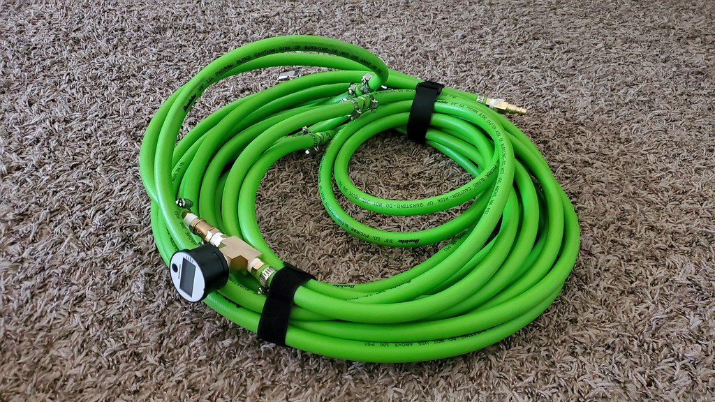

I have their 4 tire kit. Convenience is great because I can plug it in and let all 4 tires fill up. The air chucks are way better than the ones that came with my Viair 400P because it clips on/off extremely easy. It also helps with my OCD because it equalizes the pressure if you let it sit for a bit after turning off the compressor.
The only issue I ran into was the flexzilla hoses aren't made for heat. They are great for easily wrapping up and storing, but cant withstand high temperatures. The hose that attaches to the compressor burst on me. Luckily, I keep the original Viair hose as backup. The owner of Morrflate sent me a replacement that's supposed to be withstand more heat, but it doesn't wrap up as nicely due to the stiffness of the hose material.

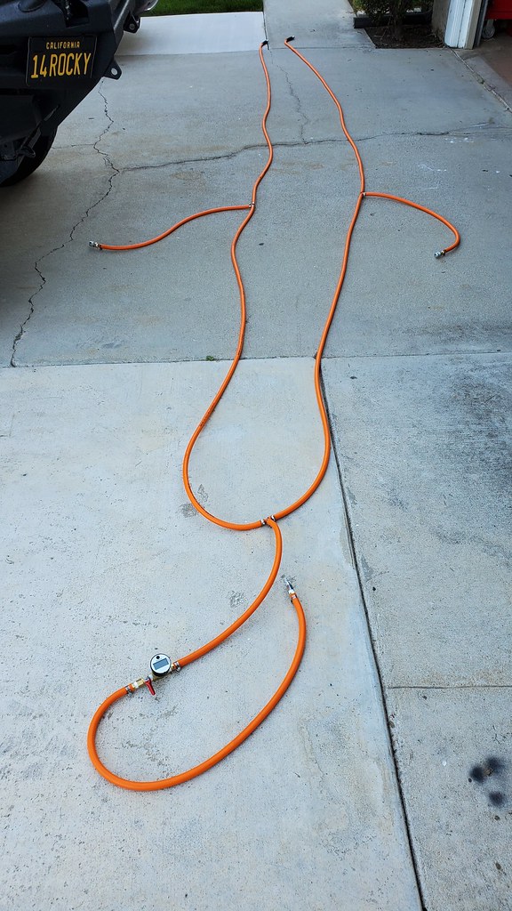

Alright my 2 tire morrflate arrived. Here are my initial thoughts:
It uses I/M quick release fittings, not the T style that the rest of my system was built on but I have extra fitting lying around so no issue. Not a positive or negative, just something to consider if you plan your projects properly (the way I don't). Note that before starting on the compressor install at the beginning of this month I was not even aware that there were multiple types of fittings.
With the compressor mounted inside the engine bay, passenger side (MORE ARB mount) I definitely needed the 25' hose I have to have the morrflate reach the back tires. I am unsure if the 15' extension morrflate sells would be long enough. Each "arm" coming off the morrflate manifold is about 8' in length, or long enough (with some wiggle room) but you will NEED an extension if your compressor is not portable.
No leaks detected, but then again all I did was use it to take my tires from 31.5 PSI to 34 PSI.
