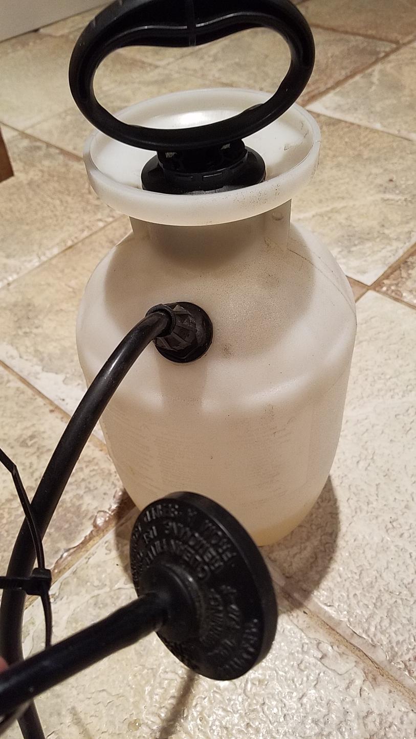

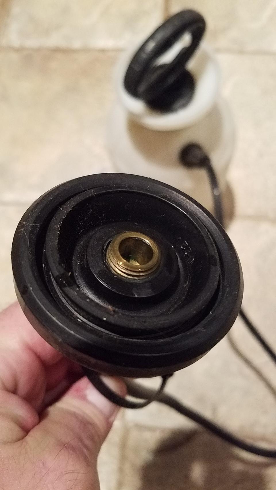

These are easy to make. I made one from a very inexpensive pump sprayer from Lowe's. I took off the handle just leaving the hose. I purchased a brake fluid reservoir cap from Toyota. I drilled a hole in the cap and hot glued a brass fitting into it. I then put the other end of the fitting in the tube coming off the sprayer. I zip tied the connection tight around the hose end and the fitting. Now, when I am going to speed bleed my brakes, I add clean fluid to the sprayer, attach the cap (and tube) to the reservoir for the brakes and put a big zip tie around the edge of the cap to hold it in place under pressure. Pump the sprayer a few times to build pressure and then start bleeding the brakes. It is quick, easy and cheap!
Here are some long overdue photos of what I made!
