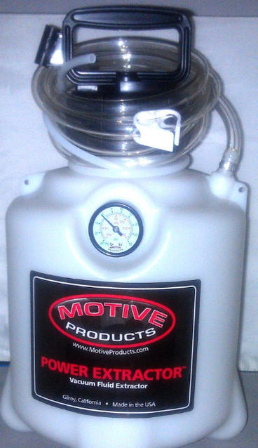

I have the Motiv pressure bleeder, got tired of the mess with the pressure cap and spills. Bought their Vacuum extractor. Not needed for the rear brakes, but way easier and cleaner for the front. Used it on our other vehicles too, no adapters needed. I use it to remove most of the old brake fluid from the master cylinder instead of pushing it down the lines. Good for power steering reservoir too.
i tried the vacuum method from our bleeders too but it seems like something is preventing the fluid from coming out.. weird.. i dont know.. eventually just gave up on that and pumped at the pedals and let the electronic pump do the rest..
