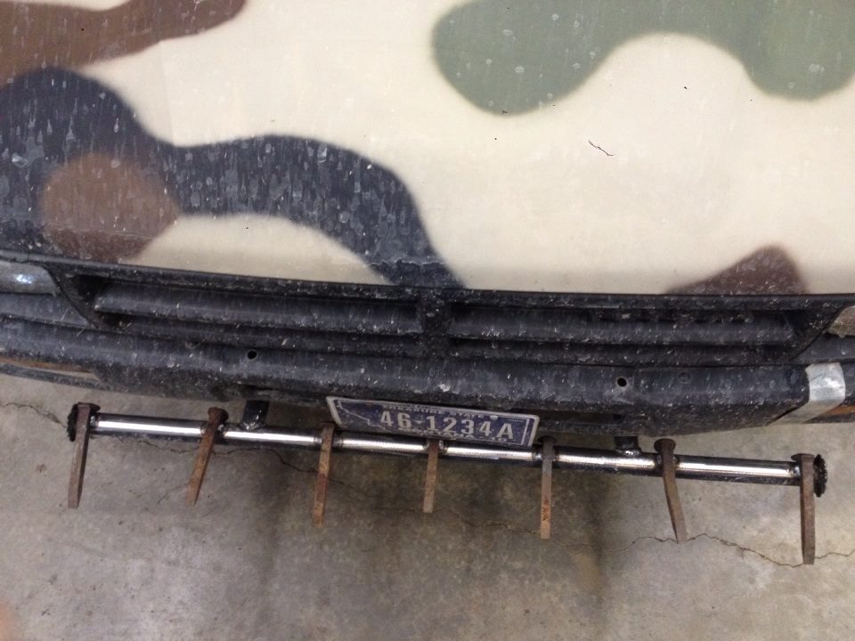

Trying to get these pics up...top one is new paint job, bottom is new bumper additions.
