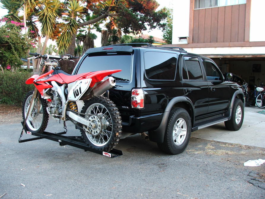

I have a Joe Hauler and it works well with my stock 2" receiver. I suggest looking for one that has a gas can tray because the last thing you need is a spill inside your car.
You may want to spend the extra money and get a good quality one. I went with the Joe Hauler brand and bought mine used off my neighbor for $200 (who happens to be professional snowboarder/skater Cara Beth Burnside, so now I have a cool little story about my hauler!). I've seen aluminum ones at Harbor Freight for $150, but I would avoid those.
When you look in the rear-view, you can see the bike moving a good amount. These do flex, but it's nothing to get worried about. I would say the added weight of the bike creates about 1-2 inches of sag, so you have to be mindful when pulling into parking lots with a steep skirt (I have grounded the bike hauler a few times but there was no damage). I recently installed tires that are about two inches taller than my previous, so I'm assuming this will help with that...but I'm also having the front end lifted which will most likely negate the added height of the tires. If you're really worried about height clearance, they do make haulers that are made for lower vehicles and put the bottom of the bike tires above the bumper line.
I wouldn't worry about modifying the suspension for this. Stiffening up the rear end would most likely sacrifice ride quality. If you're that worried about the hauler's clearance, I would suggest getting the elevated version http://www.joehauler.com/singlehaulers/singlehaulers.shtml or bigger tires :)

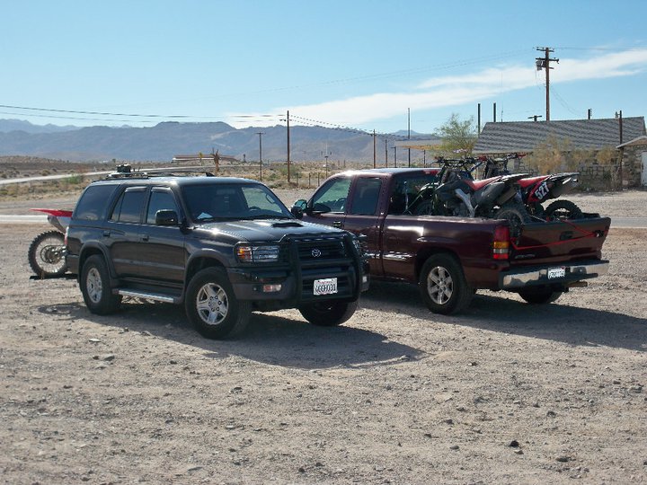

I had one of these a few years back, used it on my 4runner to haul my kdx220 around. The one I had, I had bought off ebay for like 140 delivered from a place in Arkansas. Mine came with three bolts that would basically crimp down on the mechanism that attached to the trailer hitch to prevent it from moving around inside the receiver hitch. It was great for hauling the dirt bike around and I didn't have to have a trailer.

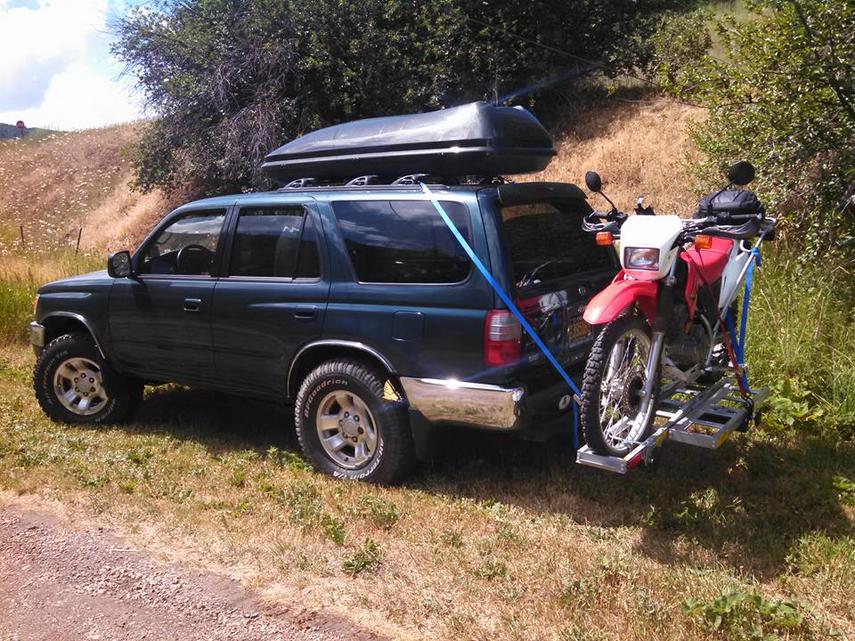

I bought a trail bike and purchased an inexpensive rack from Harbor Freight on sale. It holds the bike fine but rocks from side to side. I use tie downs to my roof rack to stabilize it. I used to run the straps as in the photo but now cross them in the back and it looks and works better.
