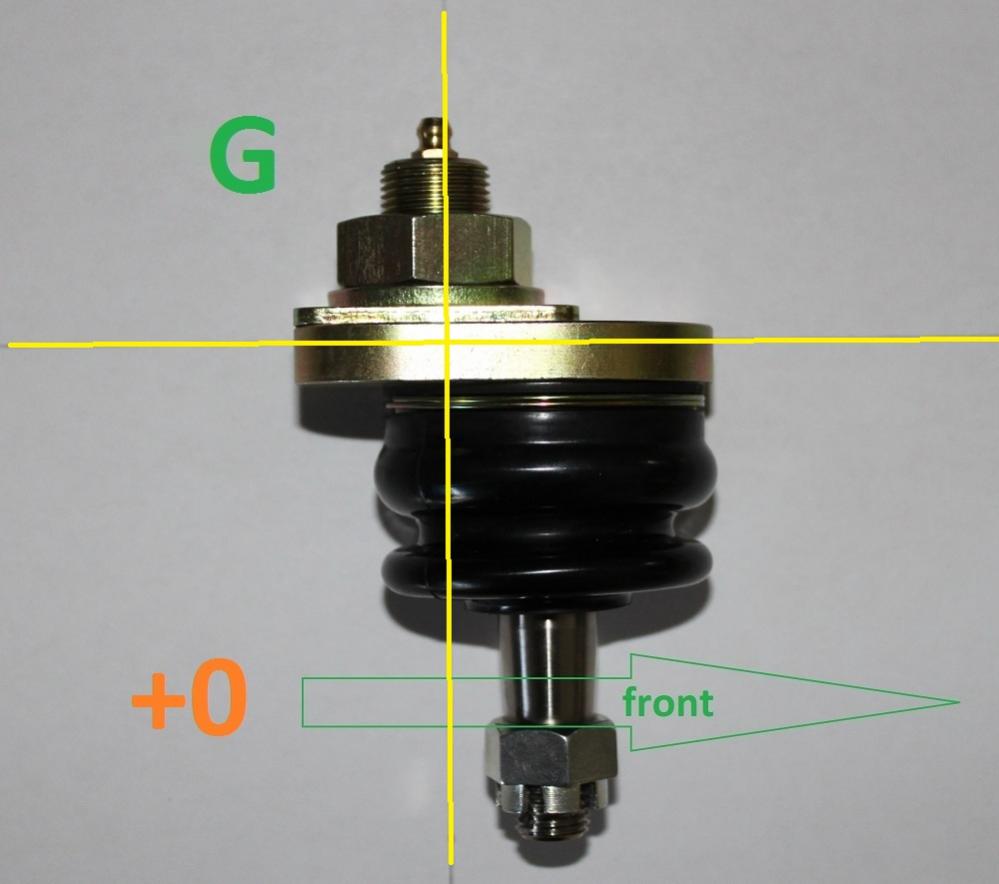

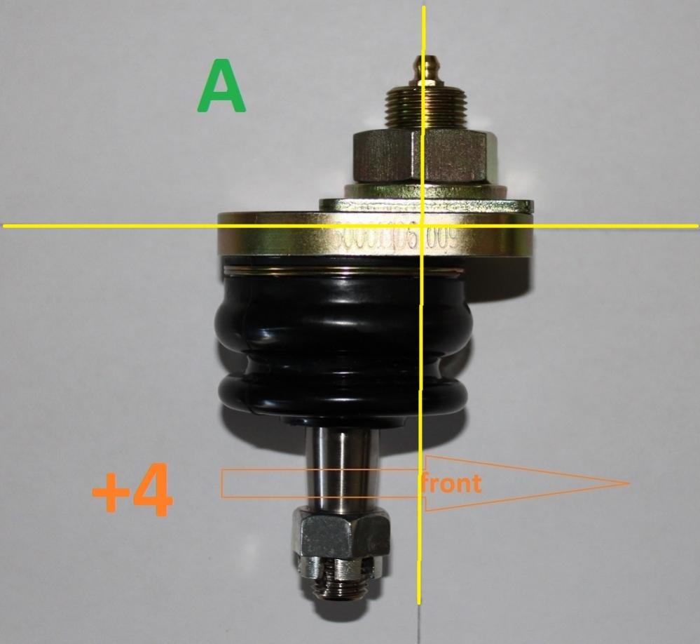

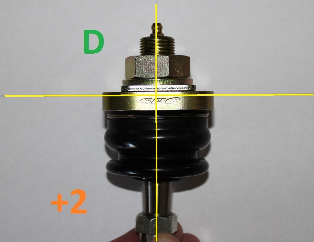

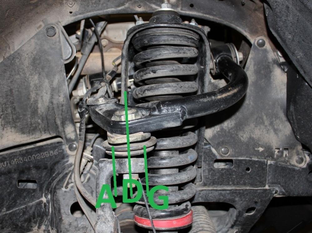

I haven’t proven this but my understanding is adding positive caster by adjusting the lower control arm moves the tire away from the body mount, adding caster with the upper control arm moves the tires closer to the body mount.
does anyone with knowledge have input on this theory?
285-70-17 wildpeaks, 2.5-1.5 lift, trail wheels, 1.25 spacers (to clear uca's), jba uca's (caster maxed to 4).
BMC was necessary. Maybe if I had gone with a different UCA that didn't require spacers I may or may not have cleared the BM. But, I didn't realize it would be an issue and now it's chopped. Would have gone 34 if I had known I was going to rub.
DO NOT let anyone say 285's wont rub. Just because it worked out for them does not mean it will for you.
Here. Using a SPC UCA.
With the SPC arm set at the 'D' setting, that is +2* castor.
If you set it to 'G' that would move the UCA to the stock 0* and forward.
3rd gen guys with BIG tires seem like the 'G' to keep the tire out of the BM.
Orange is castor.
Green is the setting.
Front passenger side. 4th gen T4R.
