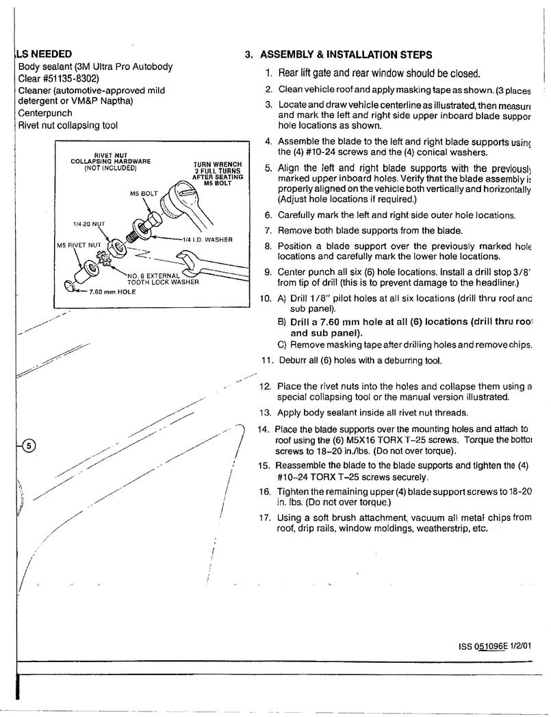

I used caulk to prevent rusting and yes you have to have a special tool. This was one of the first time I have ever used rivets and it was very easy and extremely secure. Basically, you drill the hole, put the rivet in, stick the tool on the rivet and pop! it's tight as can be. I also painted them black.
Here is essentially what the factory uses:
HOW TO INSTALL NUTSERT INSERT threaded insert demo fasteners australia - YouTube
Nutsert, aka Rivnut
The factory hardware is countersunk so it fits flush and looks really nice. A rivet, while useful and capable of doing the job, sticks out and (IMHO) is ugly.
