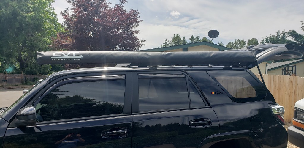

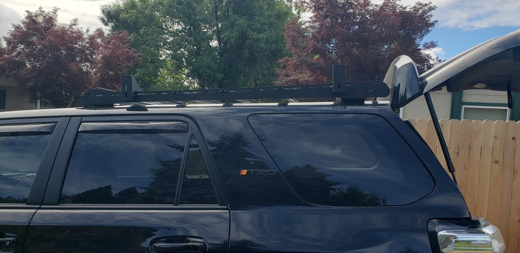

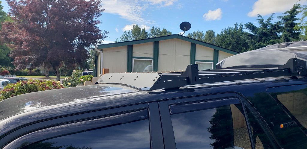

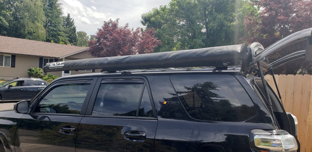

First modification was adding a 3/4 Prinsu rack with awning mounts, and a 99" CVT awning. The install on this is a mixture of various items. The roof rack itself is all Prinsu. I ditched their mounting hardware since it's not vary good, and used mounting hardware from RCI. RCI's mounting hardware is much like Sherpa, and both are far better options than Prinsu.
If I were to do a roof rack again I would go another direction. Prinsu's rack is thinner material than most and their powder coat is decent at best.

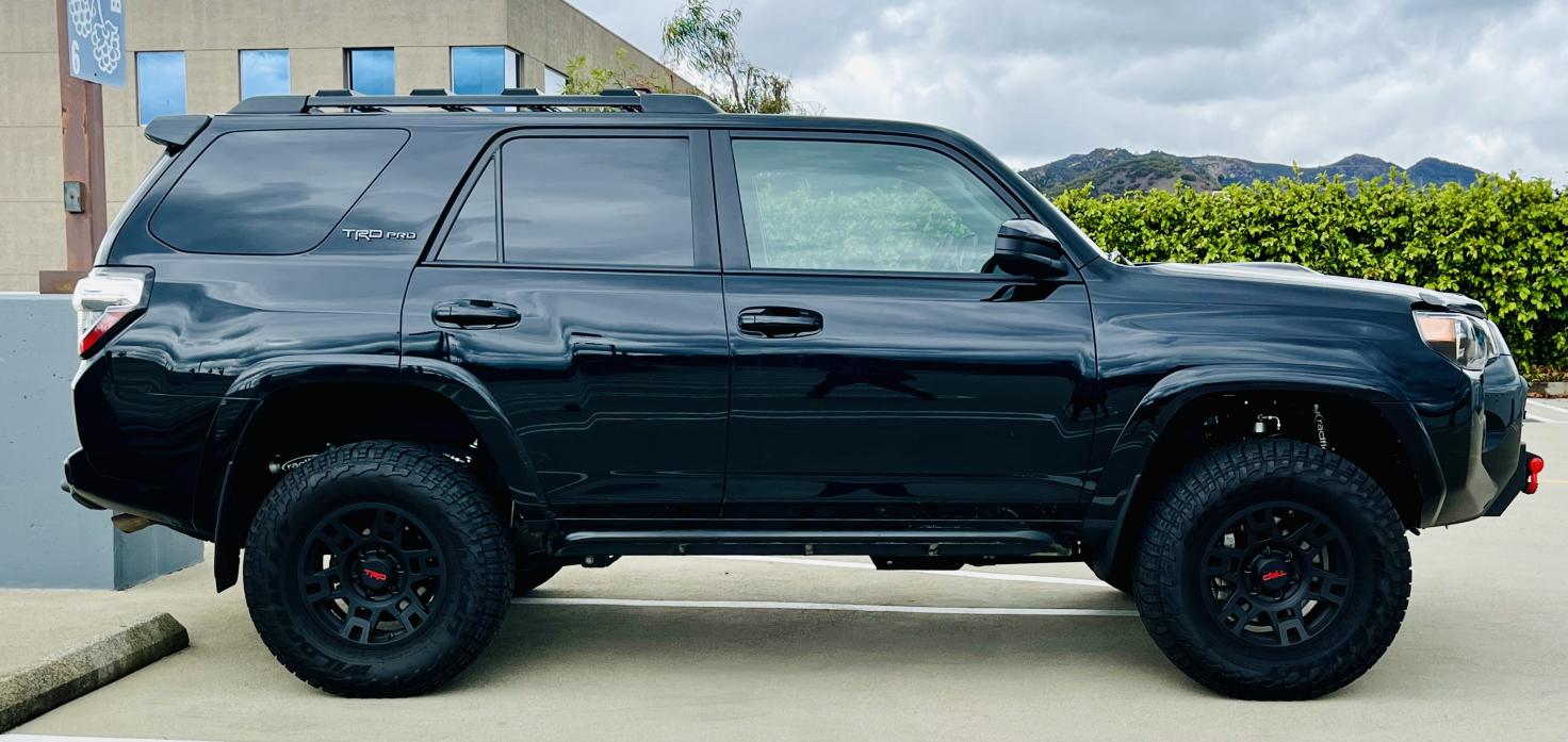

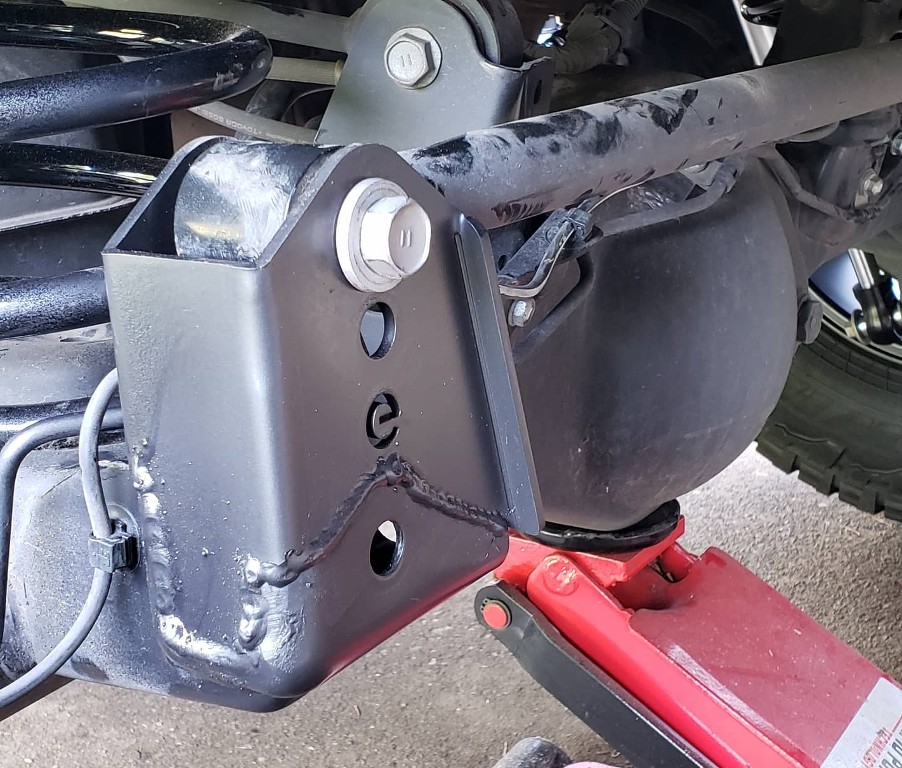

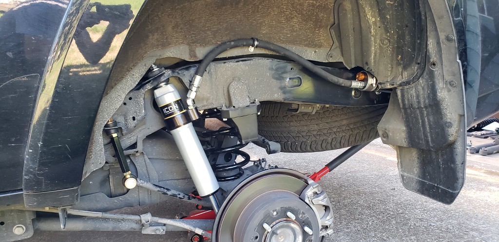

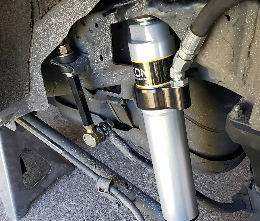

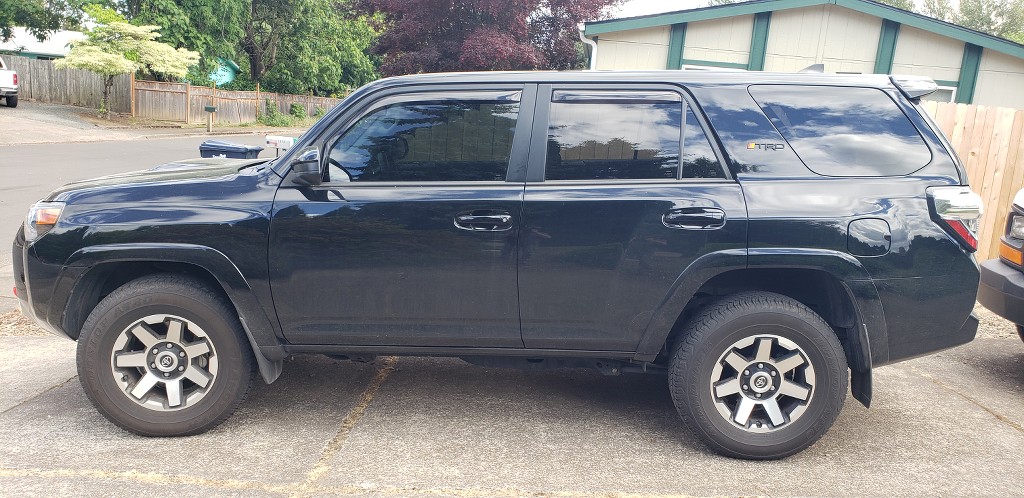

Next was the suspension along with new wheels and tires. My original choice was King, but their lead time was around 16 weeks when I was looking to place an order. So I pulled the trigger on Icon since these I was able to find everything that I needed in stock.
For the front I went with the Icon 58747 remote resi with 700lb springs. I paired these with the Icon Delta UCA and OCD forged sway bar links. Sorry, but I didn't get pictures of the front.
For the rear I went with the Icon 57810CP remote resi with the Icon Overland 52800 dual rate springs. I also installed the eimkieth PCK, OCD forged sway bar links, and Durabumps all around.
I choose Icon Rebound wheels that are satin black, and are wrapped in Falken Wildpeak A/T3 285/70/17's. I have a thing for Falkens, and run them on every vehicle I own (minus the van).
I have all three of these same items on order to finish off my new suspension lift. Your 4Runner seems higher than mine. I was looking for 2.5” of lift, but it came out to 3”. My center of hub to top of fender arch in front is 23-1/4” and the rear is 24-1/4. I am getting the OCD sway bar links for the front also. Did you do a diff drop? Something I want to avoid. Also, what about the front sway bar relocation kit. Curious what your measurements are. TIA

I dialed the front down quite a bit since I didn't have any weight on it at that time. So it's sitting a little lower in the front, and is right around where you are.
I didn't do a diff drop on this, and don't see a reason to do one either. For the OCD links, it's best to run a sway bar relocation kit for clearance issues. Most 2.5 coilovers with remote resi's will come with a relocation kit that's combined with the resi brackets.

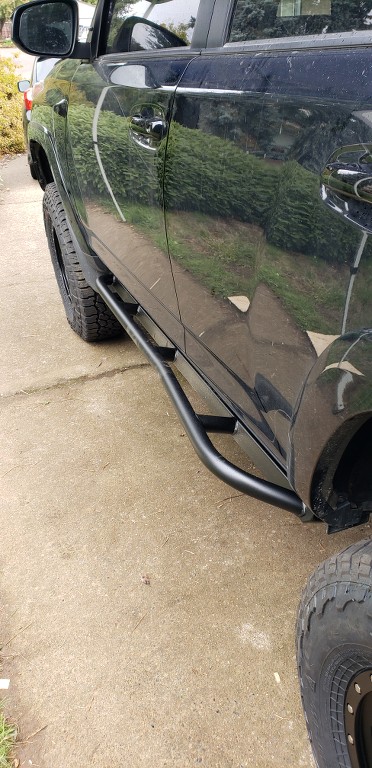

The next small project was installing some RCI 20 degree sliders. I still need to install the gas tank, engine, and t-case skid plates once the rain stops in a few months.

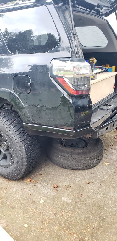

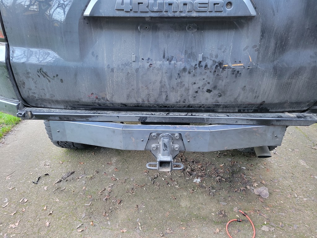

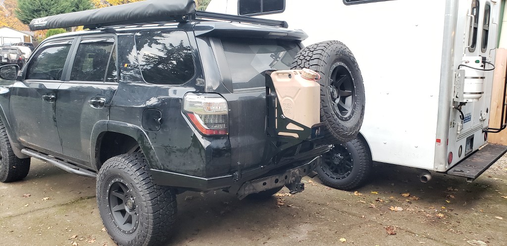

For the rear bumper I went with Nguyen Works rear bumper with a single swingout. I chose to go with the bumper that allowed me to keep the receiver hitch since I do tow from time to time. I also designed a bumper cover that really cleaned up the look of the receiver.

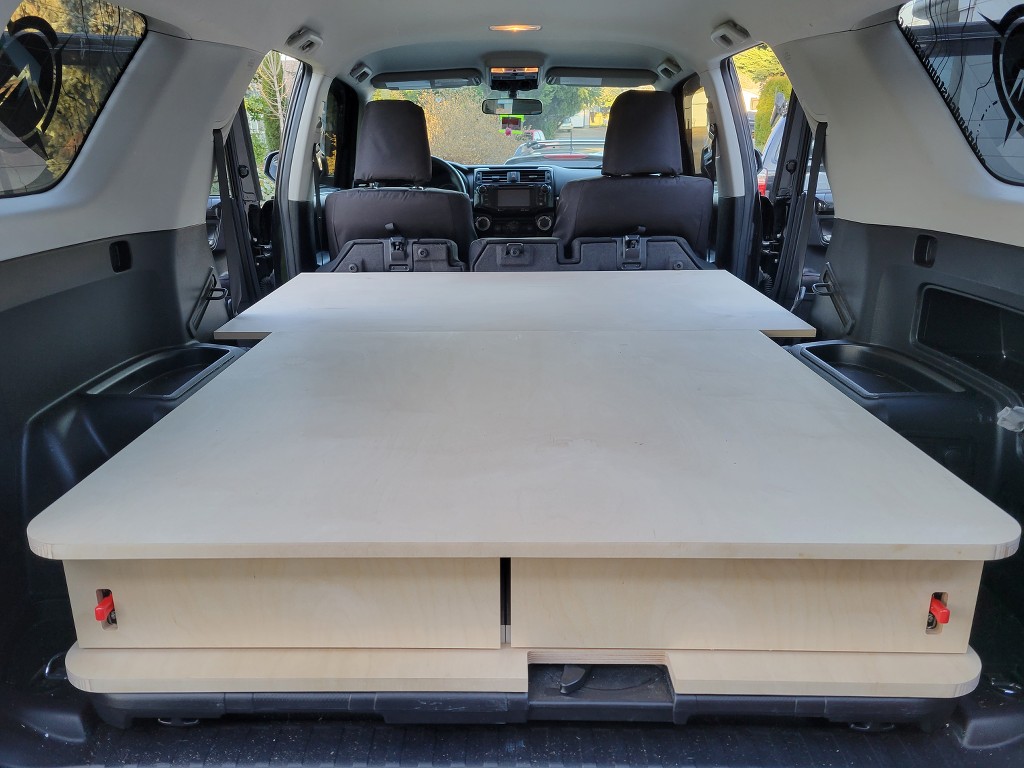

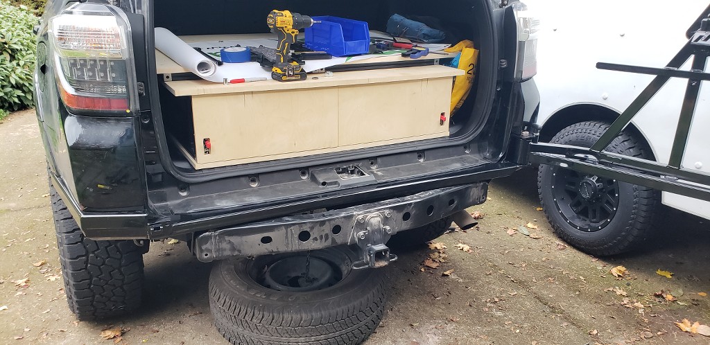

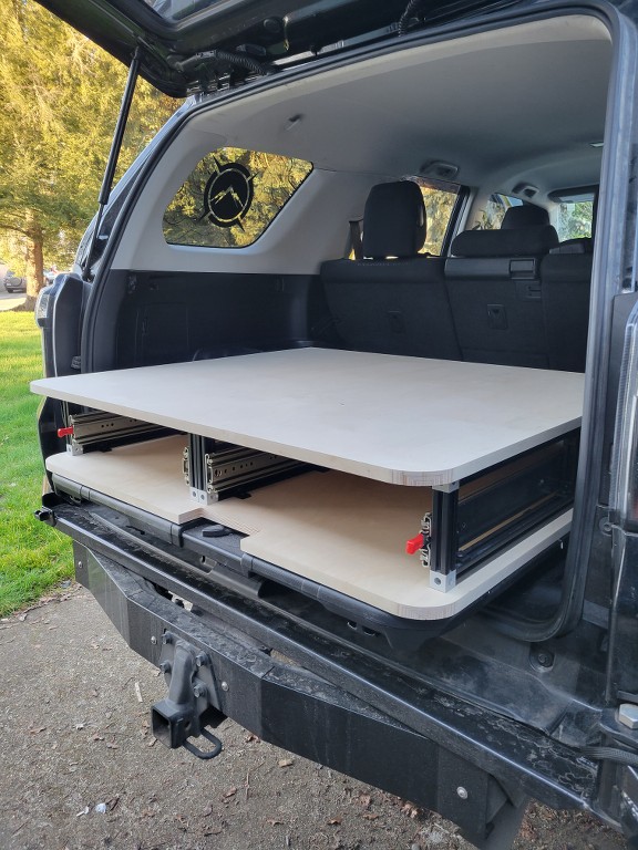

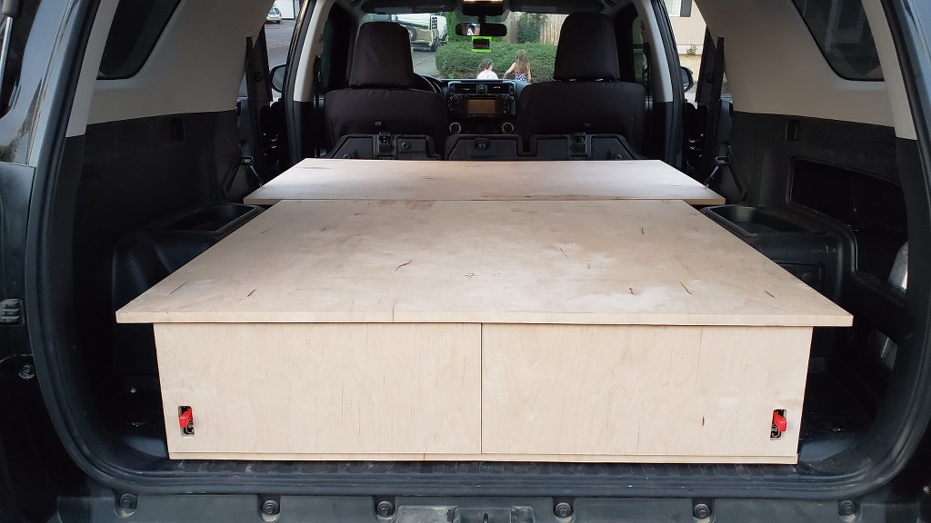

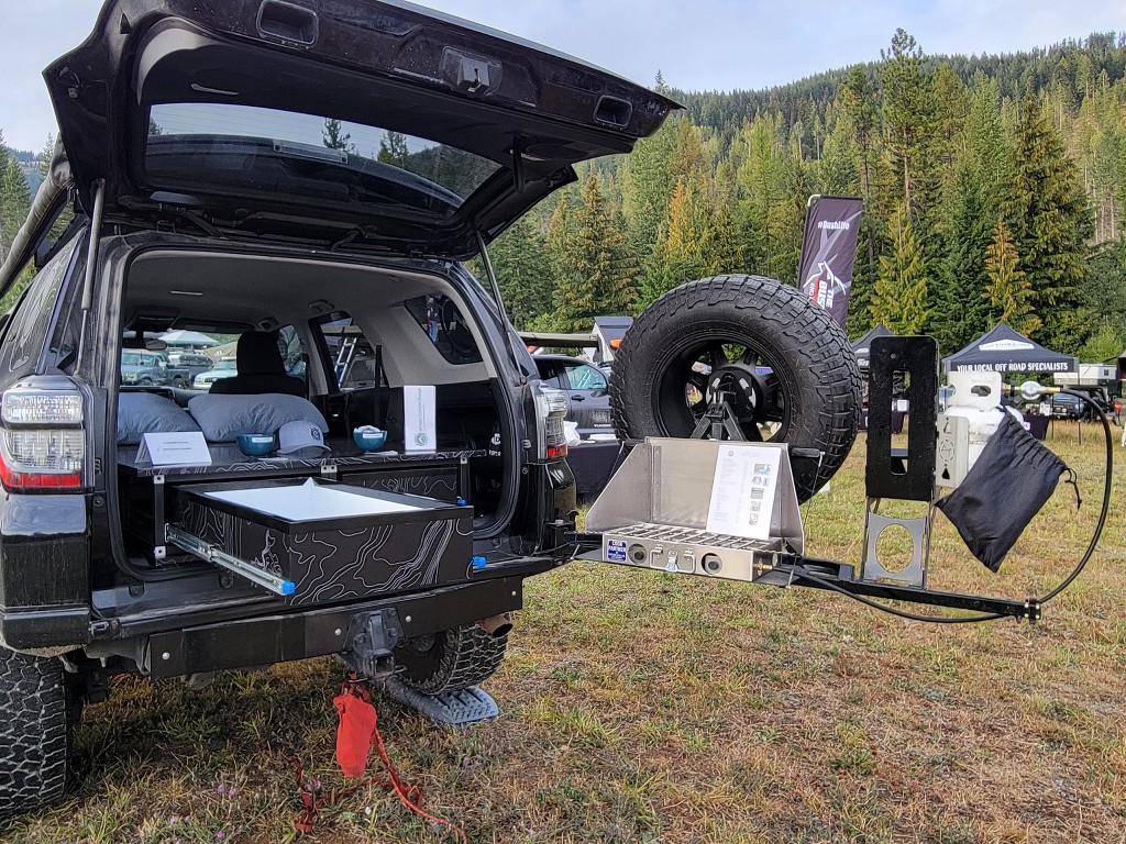

Over the past year or so I've had a few different drawer/sleeping systems in my 4runner. All of these have seen minor changes from design to design, and all allow me/you to keep the rear seats installed.
I have a 5th version in the works right now that will be pretty unique when it's complete. Not sure when I'll have it complete, but you can see it at PNW Overland Rally 2023.
1. This was my first attempt at making a composite platform.
2. Here's the first full unit with removeable sleeping deck. I ran this for about a year without any issues.
3. This is a full drawer/sleeping unit for a cargo tray.
4. Here's my current setup. This is a full composite drawer/sleeping unit with a topo wrap.

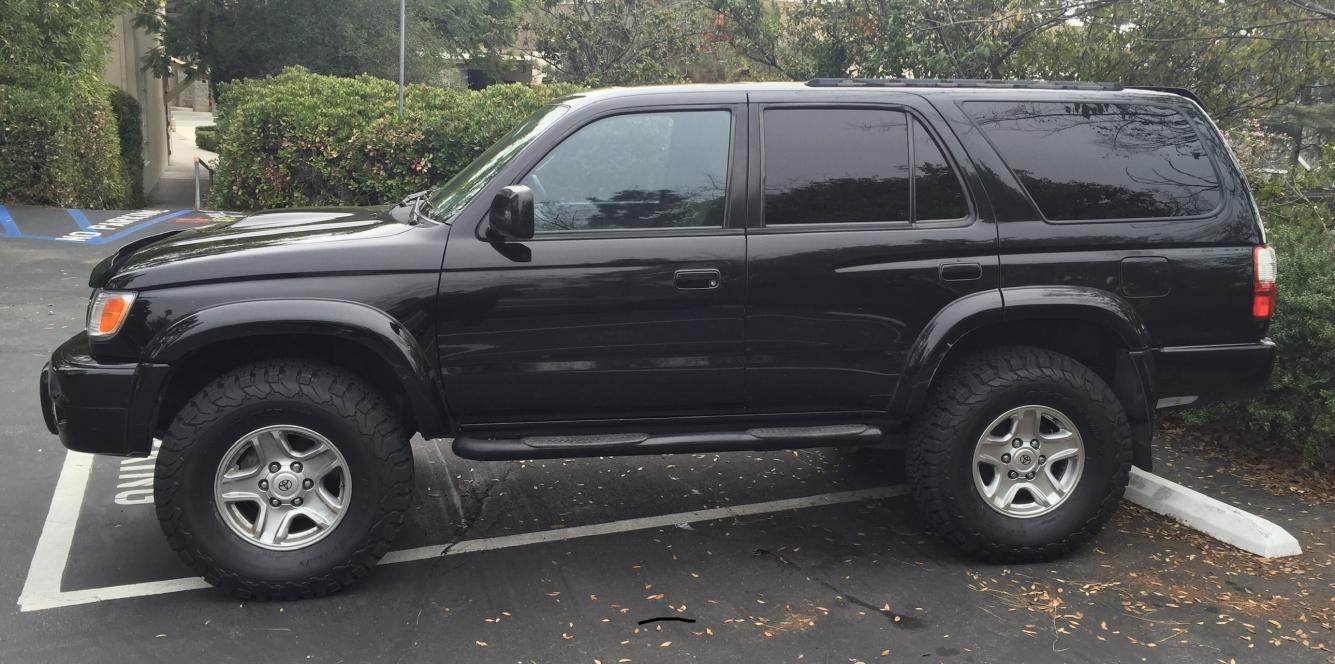

I had a black supercharged 2001 for 17 1/2 years before getting my 2018 Pro.
