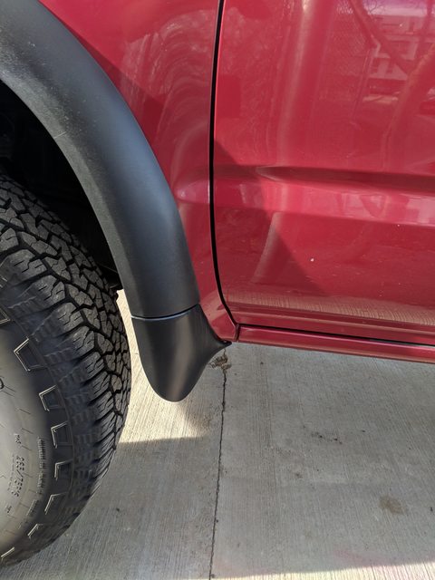

I guess there's a difference in Limited and SR5 flares...
Here are some shorty SR5 flares

Basically any mud flap will fit. There are two holes that the front end of the running board caps used to bolt to that you can uses, then fab up a small little "Z" bracket for the hole that is farther in and set back (square) to hole the inner bit of the mud flap.
Also note that the first gen Tacoma mud flaps fit on the 4Runner. You can model the size and fit from those, or find a set (they are expensive though!). No writing on the front flaps, just the rear for the Tacomas...

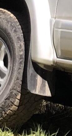

$20 from Autozone gets you a universal. I wish they were a bit lower. My limited rear fender flares have pit marks from gravel hitting them.
As long as they don't get sucked up when backing up or ripped off offroad, the longer the better, basically...
I put on a set to help keep the front doors from getting dirty and the sliders from getting too sand blasted. We will see how they last.
