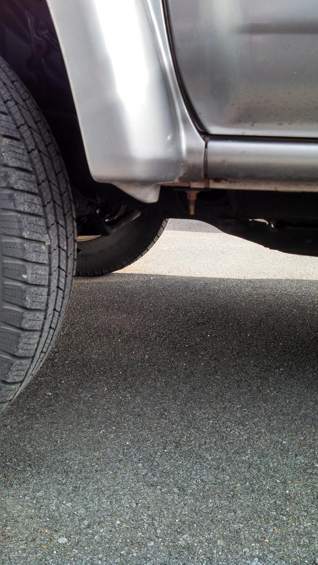

I'm having the exact same issue, also on a '99 Limited. I took my running boards off and purchased the above mentioned flaps, but for some reason they just don't quite fit correctly on the Limited flares. Maybe the SR5 models don't have that extra little "hump" on the bottom (see pic), or the flares themselves are a slightly different shape? Does anyone with an SR5 with the fatter flares have a picture that they can share so we can compare?

I have a Limited with the running boards removed and I'm having the same fitment issues as above. I've trimmed a ton off of one to test fit and I see no way of this working out. I think the hump from the running boards is the main culprit as it pushes the mudguards down and away causing the fitment problems. The non running board flares don't have this so we either need to do without the mud guards, replace with the flares that don't have the hump or cut the hump out which in doing so will make for better drainage IMHO.

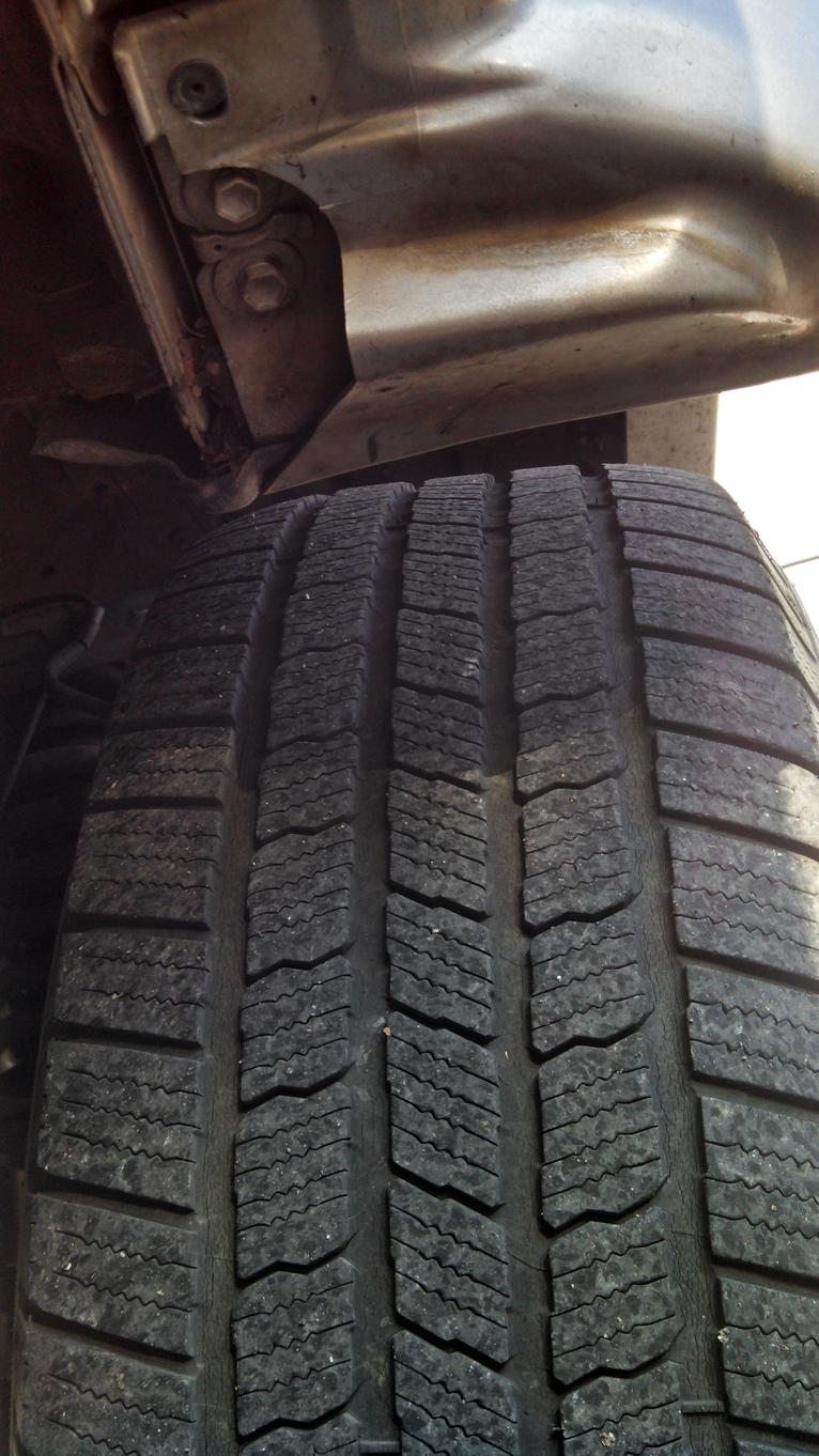

Another shot from underneath:
