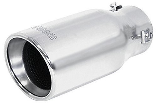

I used the 3A racing 62-2417 screw on $35 at pep boys.
Yep, those will work great and are pretty nice and are made for pipes 3 inches or less. I just went and measured the outside diameter of the tailpipe and it is 2 3/4 outside diameter for the last 4-5 inches. So any aftermarket tip will work that is at least 2 3/4 inches.

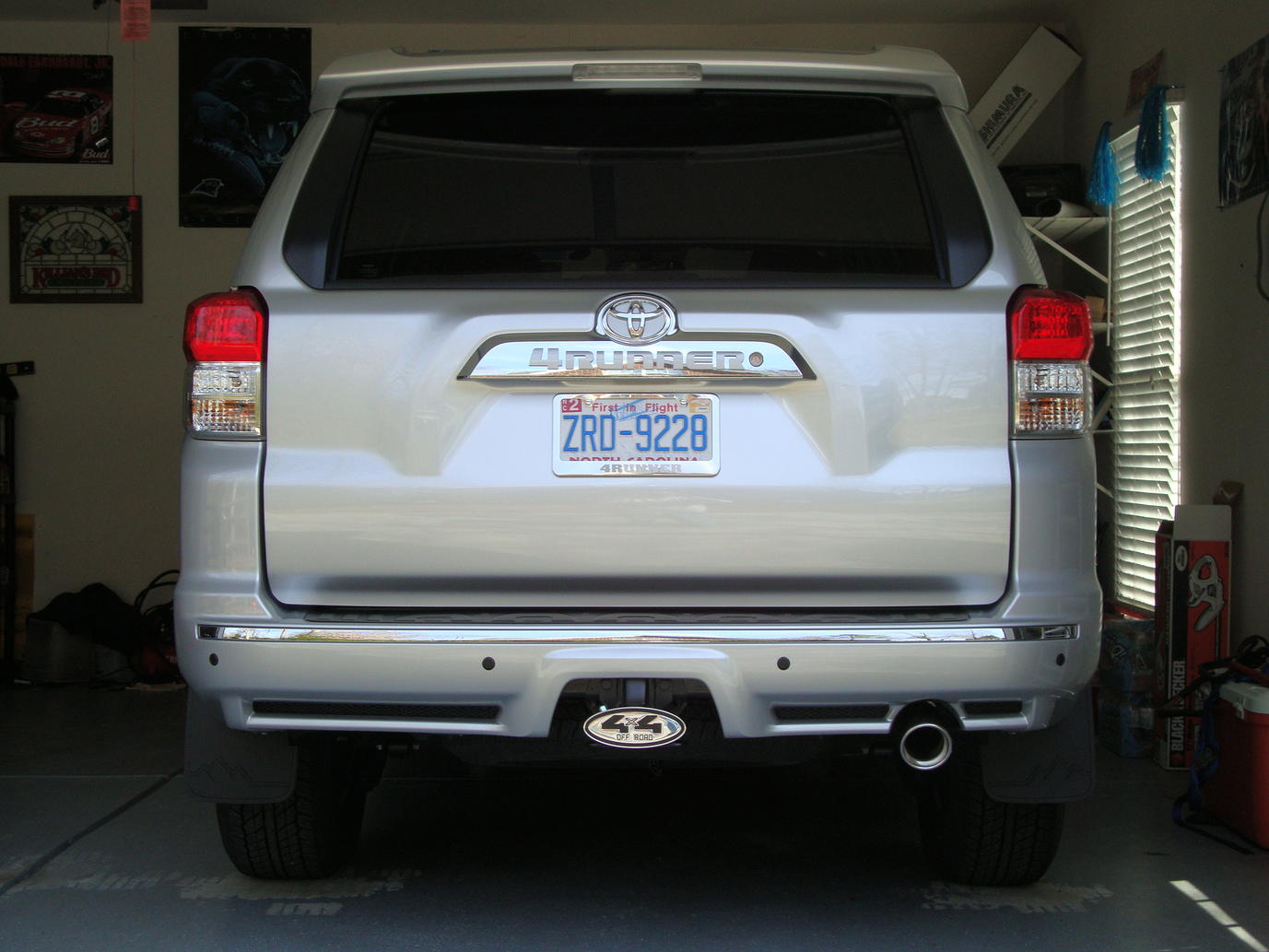

Thanks SR54Runner10! I just installed the 3A racing tip. Here are some pics.
<a href="http://s791.photobucket.com/albums/yy191/ttown311/?action=view&current=DSC_0127.jpg" target="_blank"><img src="http://i791.photobucket.com/albums/yy191/ttown311/DSC_0127.jpg" border="0" alt="Photobucket"></a>
<a href="http://s791.photobucket.com/albums/yy191/ttown311/?action=view&current=DSC_0126.jpg" target="_blank"><img src="http://i791.photobucket.com/albums/yy191/ttown311/DSC_0126.jpg" border="0" alt="Photobucket"></a>

The exhaust pipe is 2 1/2" and flares to 2 3/4" the last 3-4 inches so you need a 2 3/4 " inlet or larger. Here is the one Ttown has on his .... Amazon.com: 3A Racing 62-2417 Stainless Exhaust Tip Slant Bolt-On Truck 3" Inlet X 9": Automotive
Just google " 3 inch exhaust tip" to find some more. You want the bolt on type.I'm looking for a black stainless one myself.
