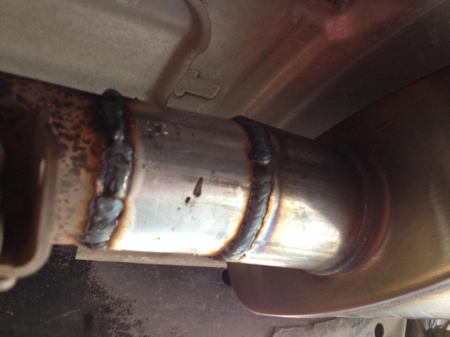

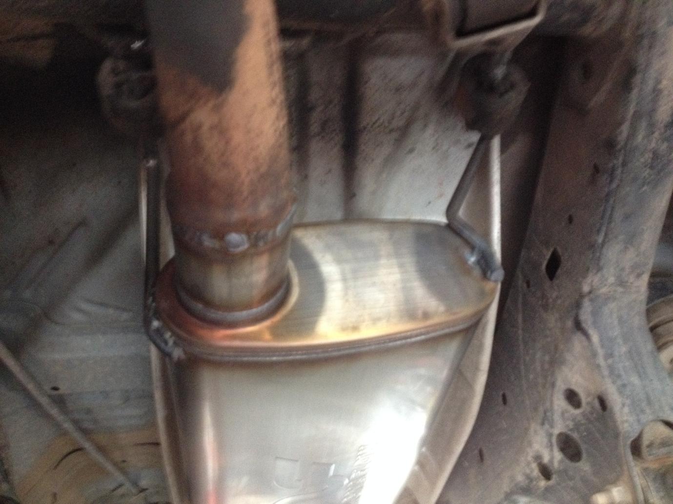

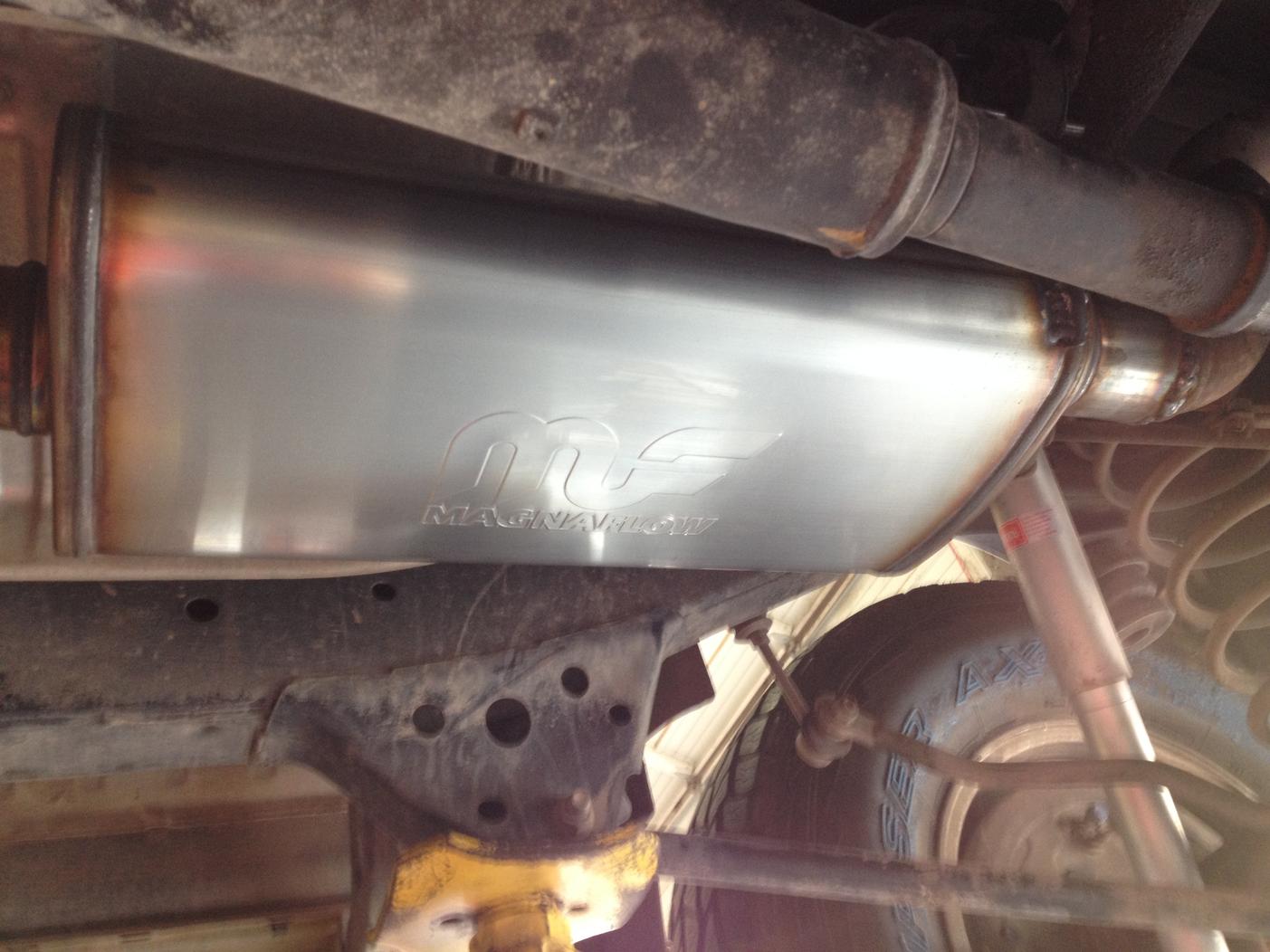

For those interested i ended up getting a Magnaflow 2.5 12586. It fit the stock piping pretty well but i had to flare out the tailpipe just a little or there would have been a small gap to fill. Sound is great at idle it just a little louder than stock. Driving normal you can barely here it but hit the gas and it make some nice noise, deep, clean, not overly loud and no tin can or raspy noise. If you want it a little louder a smaller Magnflow 11336 or 11226 would be a good choice or a Flow Master 40 series. I went with a stock length muffler at 21".
