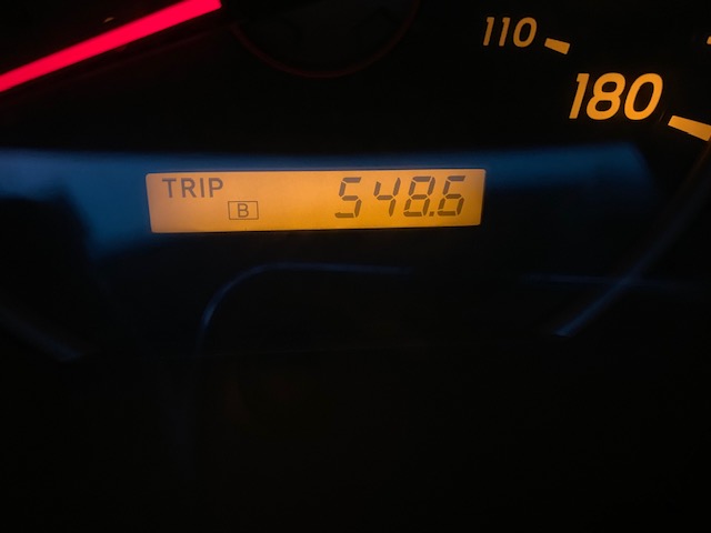

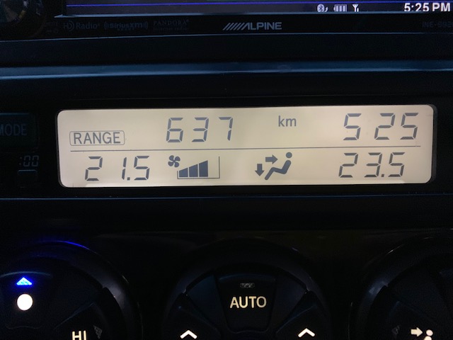

So I filled up last night with 78 litres. '06 LTD V6.
80 litre tank or 17.1 US gallons
I always reset trip odo when filling up
Trip odo showed 548 kms (340 miles) mixed driving, travelled and that included probably about 50 km in 4WD.
Soon as I moved, range counter reset to an est. 637 (395 miles) but I rarely hit 600.
