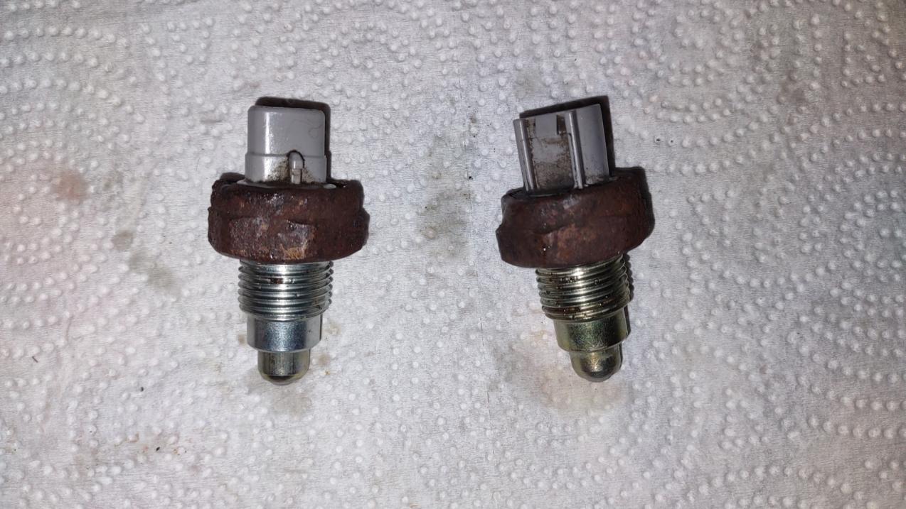

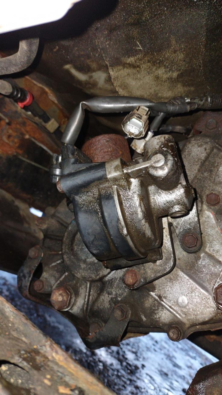

Finally got underneath and removed the two switches (sensors) on the actuator. The one closest to t-case was NFG. I hope this was the only problem. The vent/vacuum line was a little crusty, so that got cut back to good tubing and reconnected.
New amazon special switch (84222-12010) due tomorrow. Will update tomorrow.

Great job! How did you go about removing the switches? I have heard some people able to get them out with crows foot wrenches and others have lowered the transmission slightly.
I managed to get a 1 1/6" full size wrench in above the driveshaft. They weren't that tight and was able to break them and unscrew by hand. I sprayed them first with Brake Clean, wire brush and then some Kroil.
Same thing for tightening. hand tighten and then maybe a flat or two with the wrench.
