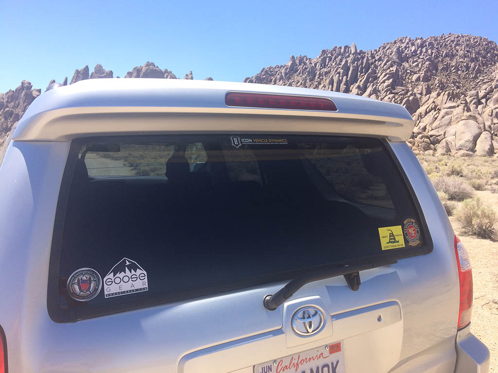

After putting my RTT on and having to push it forward more than I'd like to, I've learned there are a couple different versions of the 4th Gen spoiler.
Are they interchangeable? I would love to just take it off, but then I would have two holes on the hatch, and no third brake light, since it's not actually cut out of the steel door, it's just an indentation.
I've seen on ebay there are quite a few "oem" (ebay oem and real oem seem to differ, haha) spoilers on there that look lower profile.
Has anyone else taken off their spoiler? If so, how does it look?
Here's the one I have

Can't answer your question about taking the spoiler off, but I might be able to shed a little light on the different spoilers. As best as I can determine, the difference is factory installed vs. dealer installed. You have what I believe to be the factory installed spoiler. I have the "flatter" spoiler and I know for a fact that it was dealer installed.
Why?? I think the spoiler looks good! Lucky you [MENTION=76085]4runa[/MENTION]moc I wanted to put a spoiler on my 4th gen. I've done some research and there is a small selection that you can choose from to buy aftermarket. And as far as I know, the spoiler is just attached by a few screws into the metal body and wired with the light as follows - not too much work in my opinion
As far as I know there are two spoiler options for the fourth generation: one with the flatter look as mentioned above, and another with a sort of wind scoop designed to grab air flowing over the roof and re-direct it down across the rear window.
I've got the spoiler with the wind scoop and while it isn't perfect, it definitely does create a downdraft across the window which will blow rain and other debris off if you maintain highway speeds. That said, the rear wiper sort of negates the need for this...
The spoilers on Sport Editions are the slim ones. SR5's and Limiteds got the fat one. I think. There's a TSB or similar type of document out there that describes the two versions, but I can't remember where I saw it.

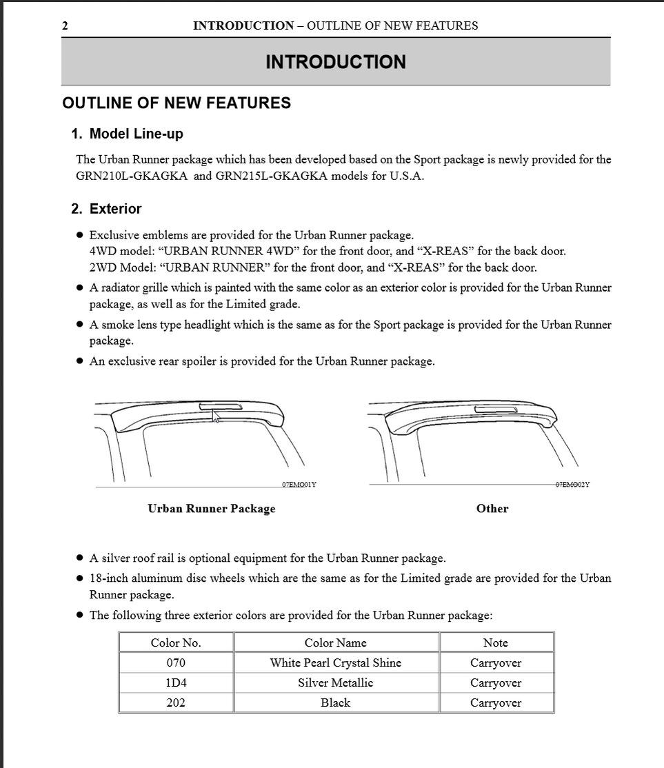

I found the info sheet that I was trying to recall regarding the two factory spoiler options for the 08 & 09 models . It's the Urban Runner package that gets the factory slim style spoiler.
