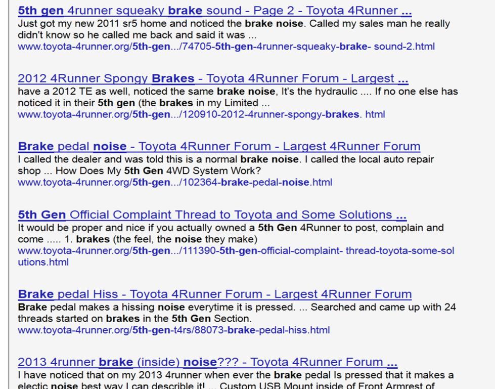

Did anyone that posted in this thread think to search?

This topic might have been discussed numerous times but I didn't find anything thing in the search.
