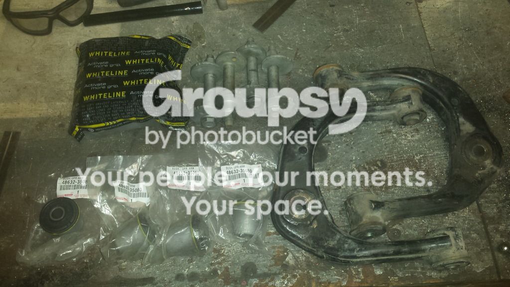

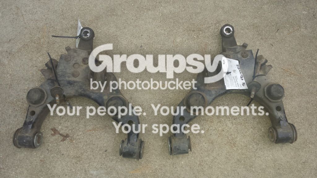

First couple parts showed up yesterday. All of my used OEM parts are coming from the west coast as well. I've also been updating the first post to reflect what parts I have.
UCA's

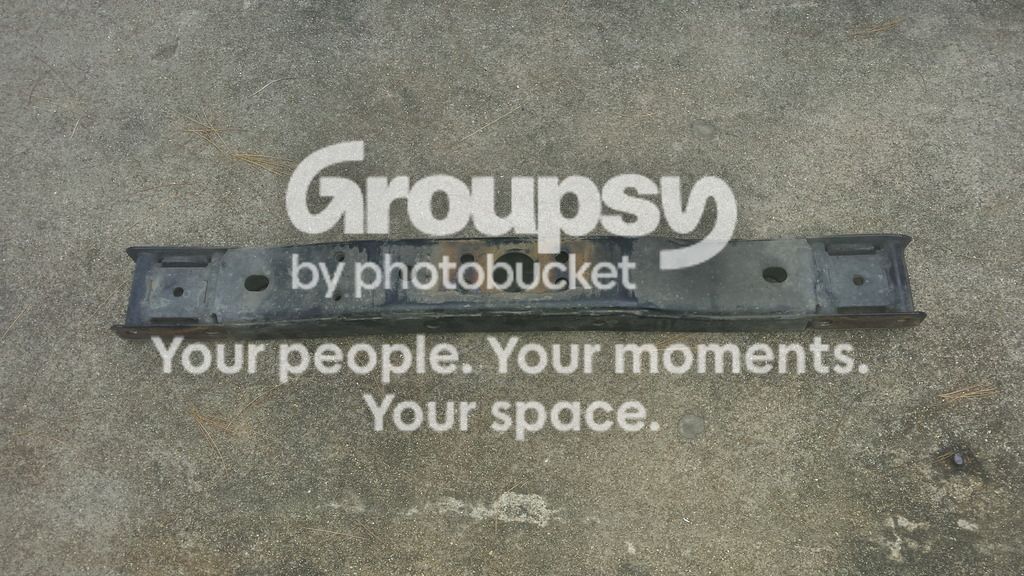

Transmission CM

Why OEM for UCAs? Seems like you might as well do SPC/LR UCAs if you're replacing them anyway
I'm not a big fan of the LR's. With the 3rd Gen's you can shave the stock UCA's to gain more clearance between the tire on the UCA. I'm going to try this route, and see what happens. I don't do much wheeling anymore anyways, and could use the money on more important parts.
