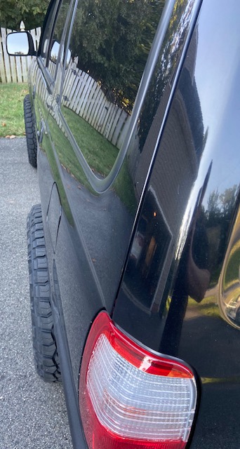

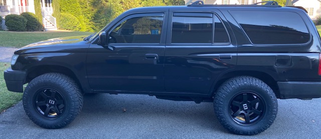

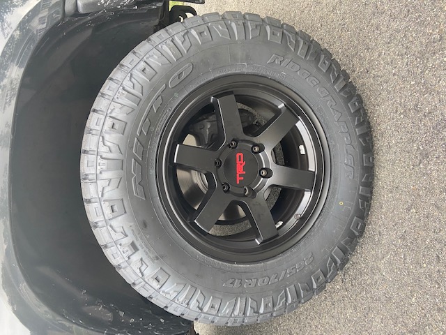

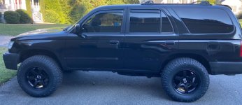

I'm very pleased with how this wheel & tire package came out. This is a perfect stance for me, but it's not for everyone.
Level 8 Mk6
-10mm
17x8
Nitto Ridge Grappler
275/70/17
No spacers, no suspension lift, no body lift. All stock, no rubbing so far!

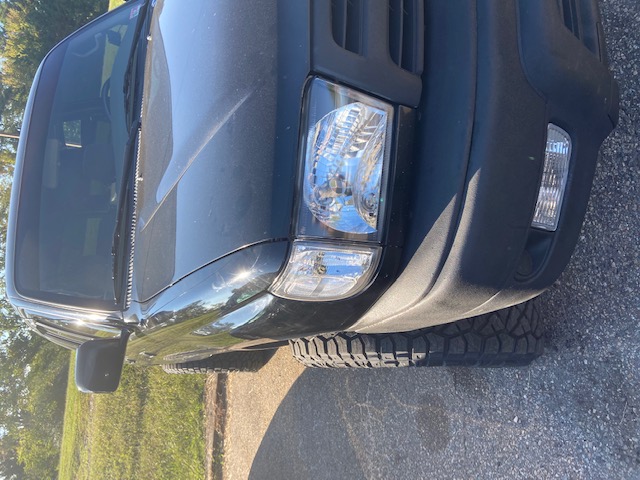

@BX Built headlights installed! :clap2:

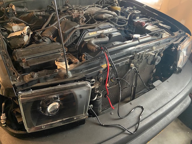

I'm going to be installing mine in the next couple of weeks and have a couple of questions. Where did you end up routing the wires? Do you have switchbacks, and if so where did you tap into the turn signal wiring?
Passenger side wiring I ran right along the lower edge of the radiator (see picture).
So I don't have switchbacks. I just went with a plain projector/HID setup.
