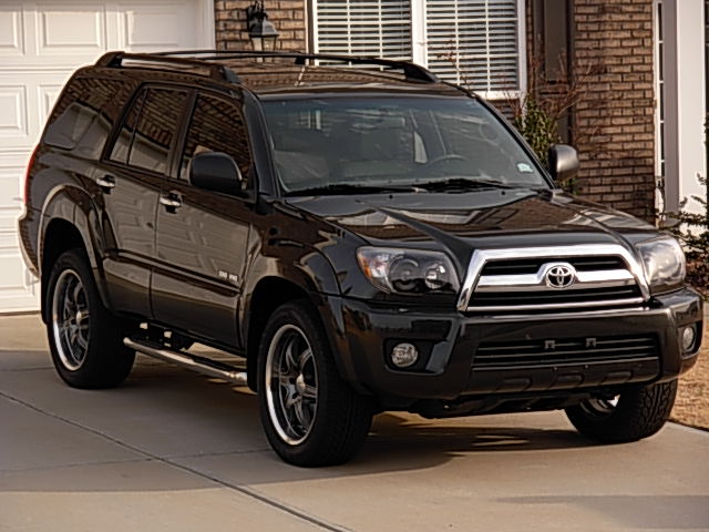

Looks great! Wasn't sure about he Nerf bars but they look awesome...pin stripe looks better now too...good job!
I was wondering about your headlights.. Did you paint them yourself?? Or are they depo one? I want blk hdlights just wondering what the best route
How did you black-out the light buckets. That would look good on my Limited.....maybe even body colored.
Great job
Great job
I LOVE the look...u should try it...its about a 3 hour process....u have to take the lights off....take the screws and rubber parts off...stick a light in the oven about 10 minutes at 200 degrees then pull the apoxy apart...then paint the chrome piece after taking off a few screws then reassemble....put them back in the oven for the same time and remelt the apoxy, screw back together and ur done. (do one headlight at a time and take the bulbs out ofcourse)
Took Advice
I removed the pinstripe which many told me too...and well i like it a lot haha...heres some pics

Looks much better without the pinstripe. Was it just a decal or painted on like mine was? Removing a painted pinstripe is a PITA.
