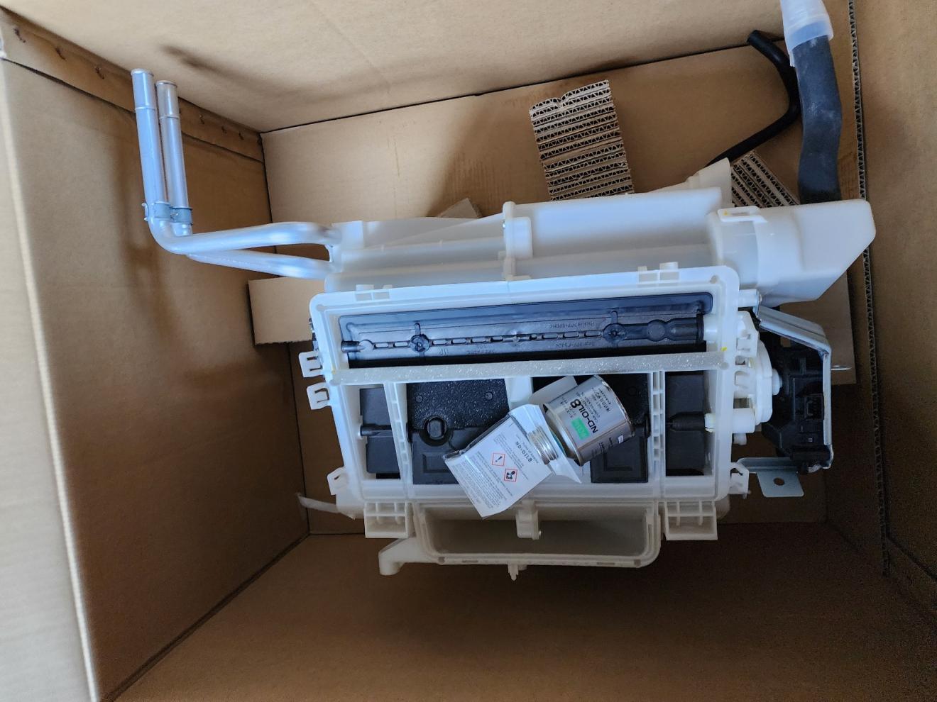

I ordered the entire duct assembly from Toyota. Contains all lines, heater core, evaporator, actuators as well as relevant orings and fastners as one preasembled unit. Was $1400 but I figure it should last for another 15+ years. Part number is (87050-35070). Dealer said there was only 3 parts in the country, soon to be 2.

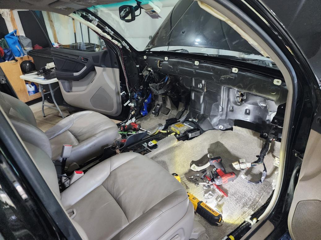

Completed the evaporator assembly swap this weekend. There is padding on the firewall, didnt end up putting any sound deadening on. Can comment that the swap wasnt that bad. Took two of us about 5 hours round trip for the mechanical work. Additional time to go get a new desccant bag, pulled vaccume for about 30 minutes to boil any water off, and then a little longer to fill with refigerant. We werent certain how much oil to add, and couldnt find the value in the repair manual, but came with a can that was below the amount the system holds and how much is called for when swapping the compressor...so that entire can went in. We didnt take too many pictures along the way, but here is a picture of the assembly and naked firewall.

The piece of advise I'd give anyone else doing this...just take the crash bar and dash out as one assembly. You have the remove what sounds like a lot, the gauge cluster, radio, hvac panel, glove box, lower dash trim on both sides, the center console, driver/passenger door kick plates and b pillar trim, and remove the sterring wheel/shaft, in order to get all of the wire harness out as an assembly (rear door switch is tied to the dash wire harness and needs to be snaked up to the front of the car, but once that's done it's disconnect and separate the various body harnesses/plugs that plug into the computers in both front footwells (computers come out with the dash), 5 bolts (3 drivers side and 2 passenger, the furthest forward bolt on the driver's side can't come out without removing the door but you can easily slide it out enough) and one more antisocial nut in the center of the dash and it the entire dash slides out of the car as one giant assembly. So much easier than the videos I've seen online where people try to leave the bar in and work around it. With it out of the vehicle you can easily remove the blower mower and heat exchanger assembly from the back of the dash in a few minutes. I think we had the entire dash out in 1.5 hours...hardest part was remembering where all of the various bolts/nuts go that hold the various trim, wire harnesses and other stuff you just took off go. That was probably 2.5 hours to get it back in and snugged up. We had to back track a bit when we forgot to install the defroster duct in the center of the dash...
