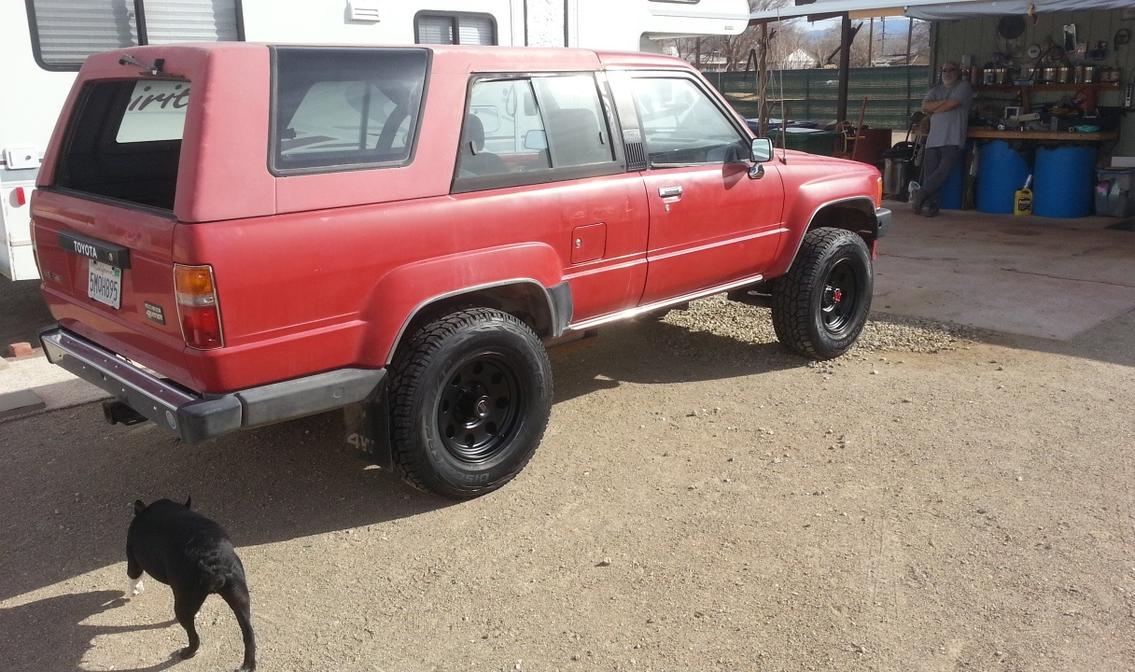

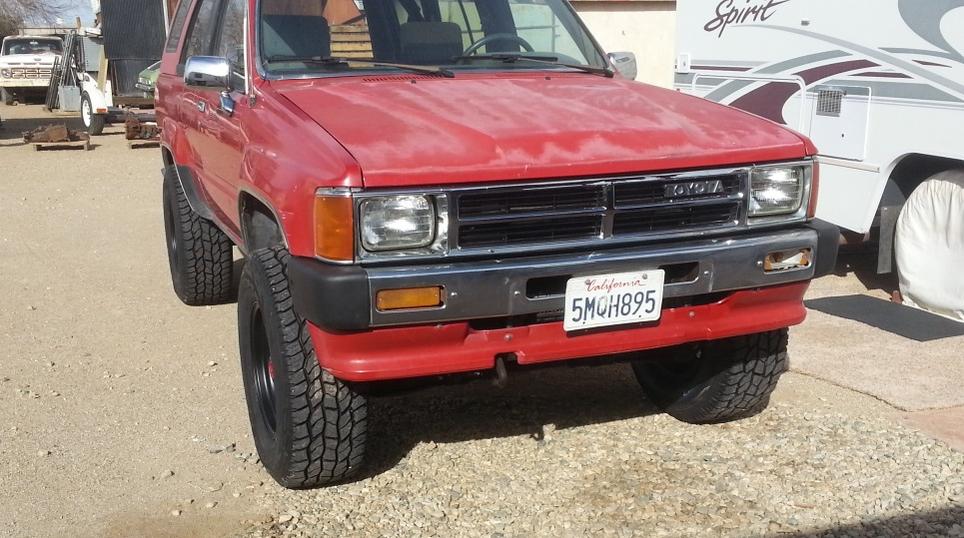

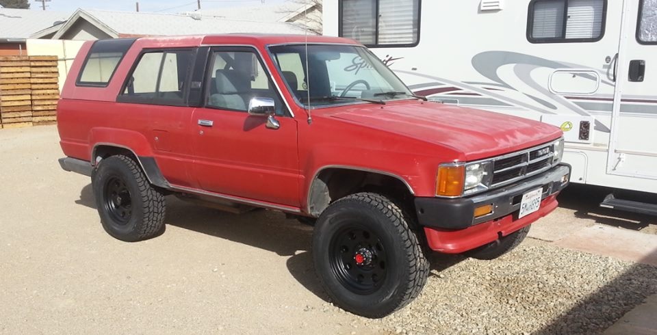

This 4 Runner was given to me because my niece knew I would fix it and return to the road ... it was stolen and the police found it before they finished stripping it ... they got her wheels and tires, stole a leaking old PS pump! I changed timing belt etc. cam seals and crank seal .. change trans fluid and filter it only has 109k, serviced the tranny and bought wheels and tires ... American's 16x8's with 265/70 R16. They fit perfect without spacers, and do not rub.
Runs great I need to replace master brake cyl and will do rear shoes ... I did replace front disc it has a bit of damage on drivers roof rail some laided it over gently because it is not to bad did not buckle roof crack sun roof but I dislike them anyway so I will paint it on inside to stop glare. Issue with windows on doors but I got a Suzuki door switch set for 20 buck and moved pins on 9 pin harness windows work but not locks etc. The front end was damaged I replaced the grill, straiten the bump and brackets, gravel shields need turn signal lens!
Hope this info helps someone!
