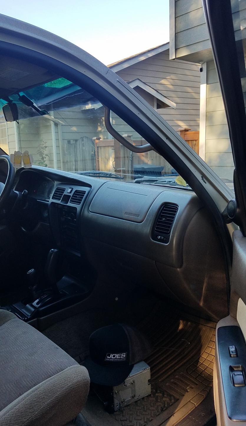

Anybody know where I can get one of the upper door seals? Missing it on the passenger side and it's causing loads of excess wind noise
Junkyard or someone parting one out.
I'm obviously talking about buying them brand new. If I truly wanted someones worn and half ripped used weather stripping, I might as well poke around at the dump, right?
Well then, the Toyota dealership or used crap.
