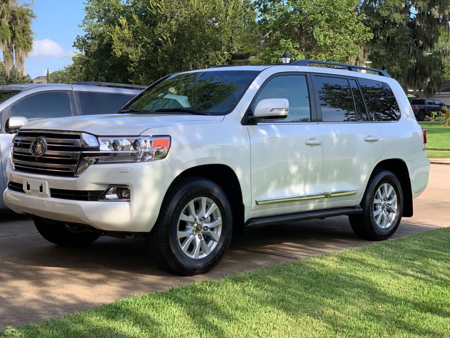

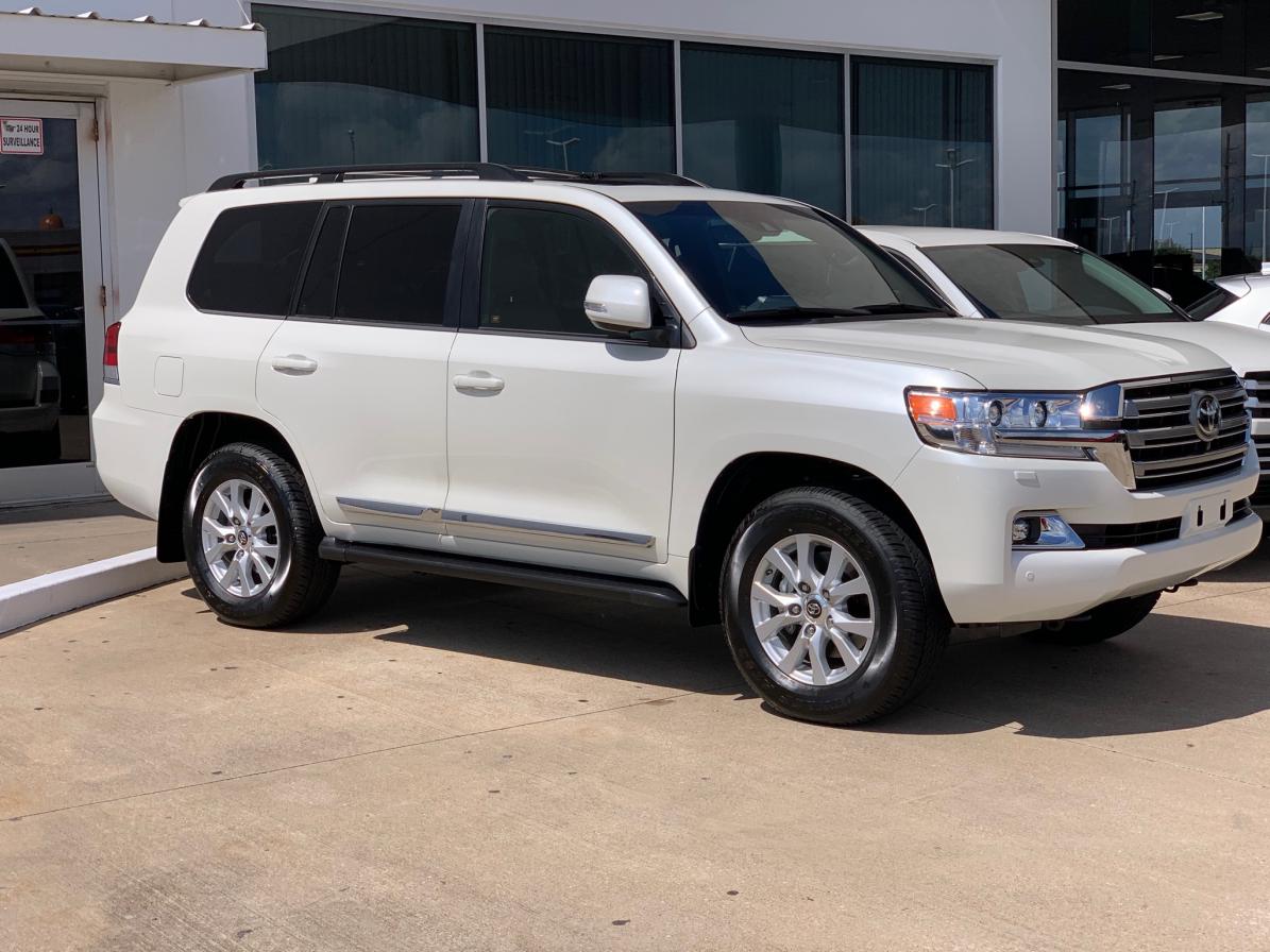

2019 Land Cruiser in Blizzard Pearl with Terra semi-aniline leather, made in Yoshiwara Plant, Toyota City.

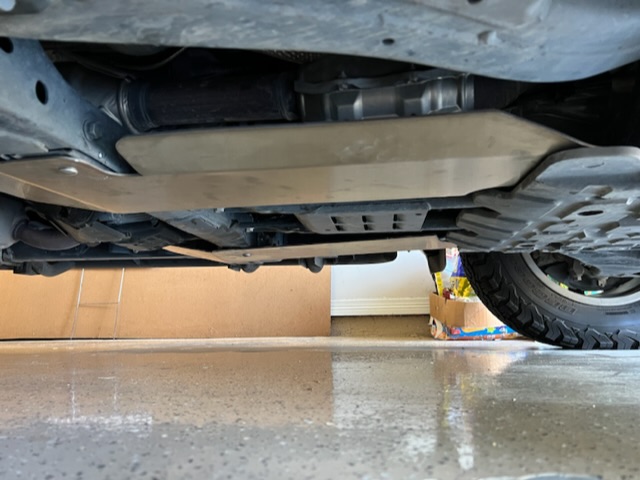

Newest addition to my LC: catalytic converter skids.

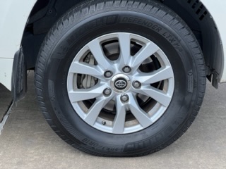

After about 3.5 years and 46k miles, i am retiring the BFG KO2. Fuel economy was going down and low speed noise was up.
So, I went more on-road friendly yet still tough tire. I went with Michelin Defender in stock size 285/60/18 XL. XL is for extra load. So, it is a little stronger than your typical P-metric and perfect for heavy LC.

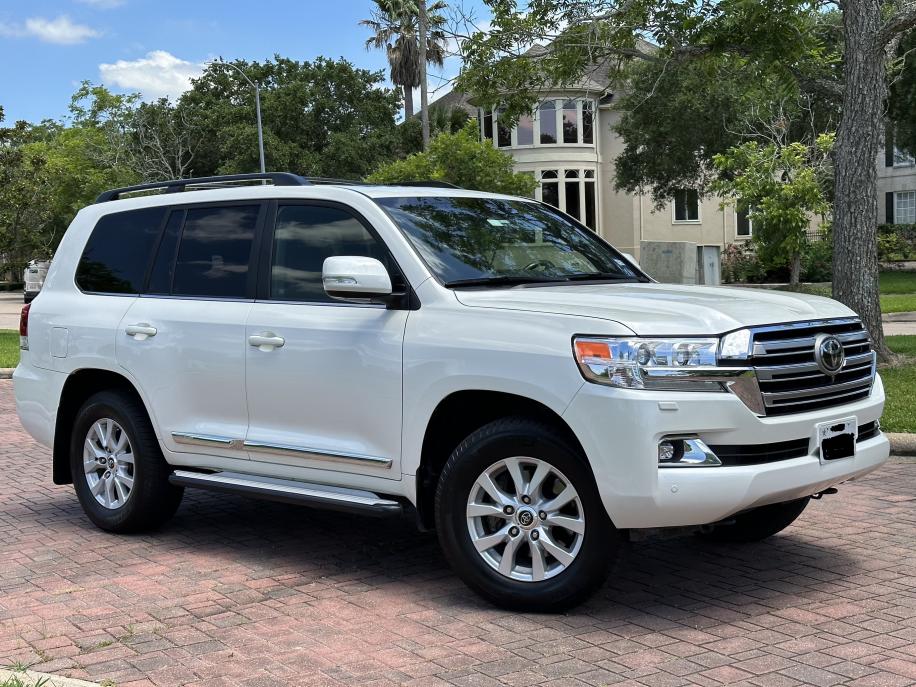

Just an update pic after getting it detailed for 1st time since it drove off dealer’s lot.

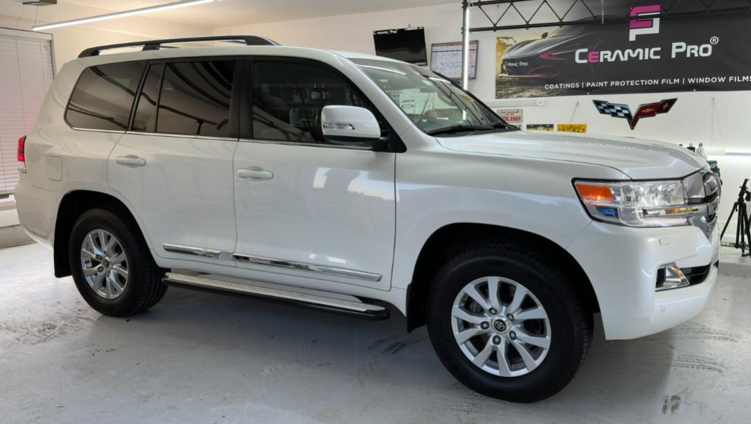

I got Ceramic Pro Gold Package (XL) (Polish+Coat) for my Land Cruiser. Lifetime warranty.
FIRST WASH STAGE
▪pH Neutral Wash + APC to Aide in Wax/Sealant removal
▪Bug/Tar/Sap Removal
▪︎Wheels & Tires Degrease and Prep
DECONTAMINATION STAGE
▪︎Iron-X: Chemical Decontamination of Paintwork ▪Clay Bar: Physical Decontamination of Paintwork ▪︎RO/Distilled/Equivalent Rinse & Dry, Water Spot Removal/Reduction
PAINT ASSESSMENT STAGE
To Determine Level of Paint Correction Needed, if any
SURFACE PREP FINAL STAGE
▪︎Solvent Bath of All Paintwork & Trim to be coated
▪︎NANO PRIMER applied with machine polisher on all paintwork
COATING INSTALL STAGE
▪︎4 Layers of "9H" on Paintwork & Trim
▪︎1 Layer of "Top Coat" on Paintwork & Trim ▪︎2 Layers of "Glass" on Exterior
Windows and Mirrors
▪︎1 Layer of "Wheel and Caliper" on Wheel Faces
Curing Process - 72 hours initial cure, with first 12- 24 hours recommended stay at coating location.
Annually, $95 for inspection, glass coating, and coating booster.
