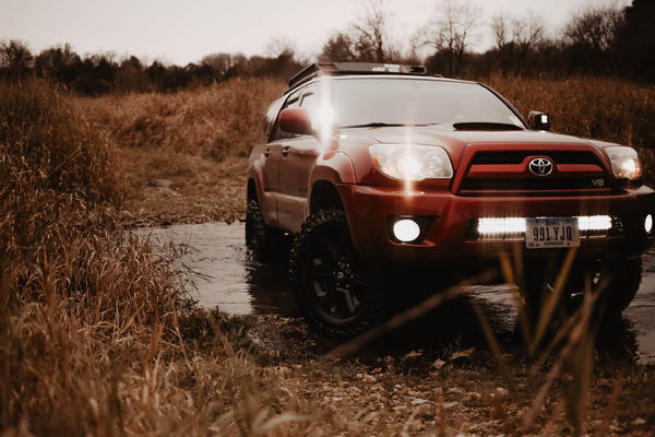

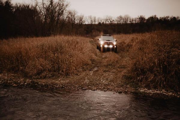

Ordered up some CBI ditch light mounts. These things are pretty beefy for just being light mounts! Added some light pods and got it all wired. Also installed a switch that fits in the blank in my dash. I'm officially out of room for switched in factory blanks:wacko:
I'll post some light output pictures later. I will say that these will come in handy and I'm glad I added them!
