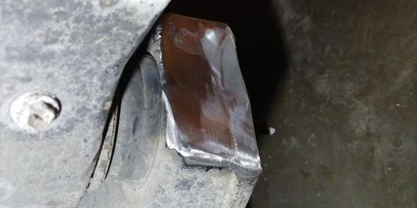

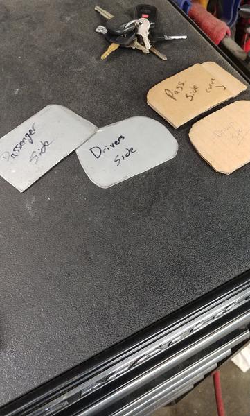

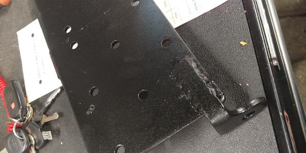

I made some body mount plates for the chop I did earlier this year. Made some templates out of cardboard and cut them out of some scrap I had laying around the shop. I tacked them in and ground them smooth and coated with some undercoating.:thumb:

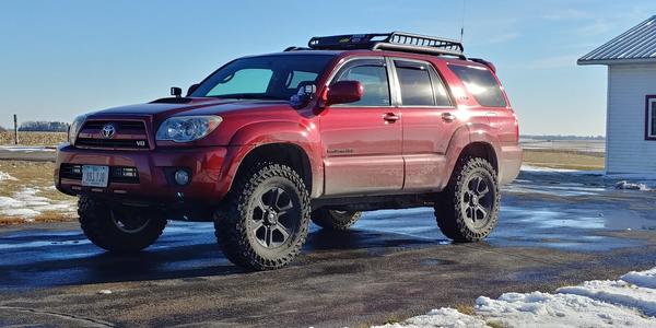

I won tires from a Yokohama contest about a month ago...well they finally showed up! I mounted them up to some 2016 4runner SR5 wheels I bedlined. I also had to cut the bumper up a bit and did a body mount chop. I'm really liking how they turned out! :bigok:
Tires: Yokohama Geolandar M/T G003
livegwudl6-jpg.14644
Now that you’ve had those MT’s for a while what are your thoughts compared to other MT’s you have had?
These are my first set of M/T tires. While they are louder than the A/T's I've had, they aren't too bad for ride quality. They are absolute beasts in the dirt and mud and actually are pretty good in the snow.
They balanced out really good and are wearing good as well.
The bad...well, this size makes my 4runner a dog and a gas hog! I really need to re-gear, but that's not in the cards right now. I'm averaging 14 MPG, but it is what it is!

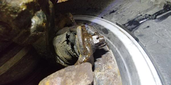

Been hearing a slight "clunk" when taking left turns lately. Today I crawled underneath and...well....shit.:mad2:
Looks like it's time for a new LCA on the passenger side. I just got an alignment too...FML. I've found LCA's from Camelback Toyota for about $280 so looks like I'll be going that route. I'd prefer to just rebuild the ones I have, but I don't feel like messing with pressing that corroded shit out.

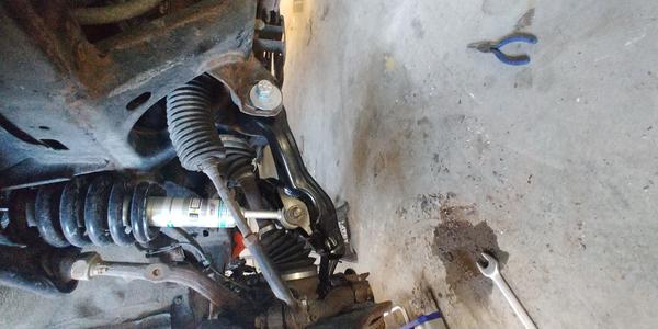

Also ordered a 1A auto LCA for my passenger side. Saw nothing but good reviews and they were over $200 cheaper than OEM. If they don't last I can always rebuild my stock one and reinstall it.:biggrin2:
Got the new control arm installed with SPC hardware. Install went super smooth. Getting it aligned tomorrow. Turns out the bushings on my old control arm were worn out as well. 190K miles on it will do that! No more thud when turning!:banana:

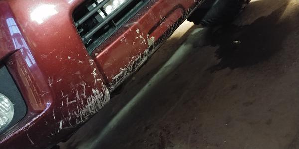

Went full send mode this afternoon. May have gotten a few battle scars on a rock ledge climb. 4runner made it up though! Time for a new steel bumper?:naughty:

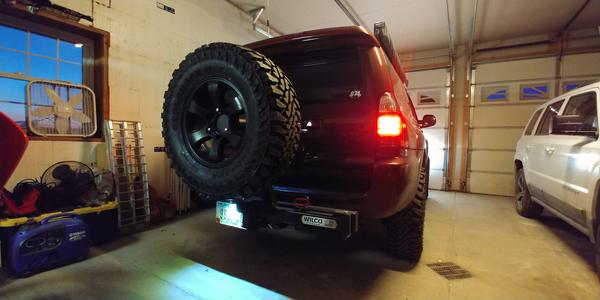

I received my tire carrier yesterday from Wilco Offroad. Got it all assembled and installed!

That Wilco tire carrier is awesome! Can you post some pics from the side view?
