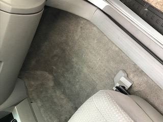

In addition to a lot of maintenance items, one of the first things I undertook on my new (to me) 2005 4Runner SR5 was to replace the passenger area carpet. This didn’t start by choice, but when I found out where all the washer fluid that wasn’t getting to the rear window was going...under the passenger side carpet in front and rear.
Once I had half the carpet pulled out, saw that the pad was never going to dry out, and learned that I could get a replacement for about a hundred and a half, the project was on.
As you can see, before and after is pretty remarkable.
Steps and photos in the attached pdf. Hope this is helpful to someone.

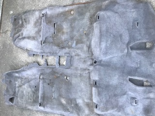

I decided to play in the mud this weekend and got a good dose into the carpet. I popped the edges up and ripped out as much of the padding as I could reach. I hosed everything out and pulled up the excess with the shop vac.
The way I like to play I have a feeling this won't be the last time I get some water/mud in the cab. I'm considering putting some of that sound dampening but that doesn't make getting the water out any easier. I wish the carpeting was actually porous so it would dry out. No such luck.
Option B is just to cut out most of the carpeting. I run the weather tech floor liners and they cover the vast majority of the floor anyway. Seems kind of a waste to hack some big holes though.

After reading this thread I went back and pulled the center console and the rest of the trim holding the carpet in place. The pressure washer blasted off most of the spongy backing material. I gave the "up" side a good cleaning too so it looks pretty good.
Now I'm considering what to do with respect to replacing that padding. I've got some leftover closed cell foam in the attic just taking up space. I've got a few days until the carpet dries out so I'll keep looking.
