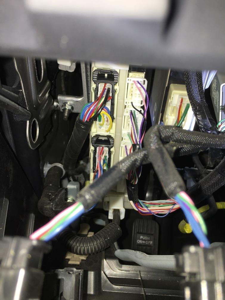

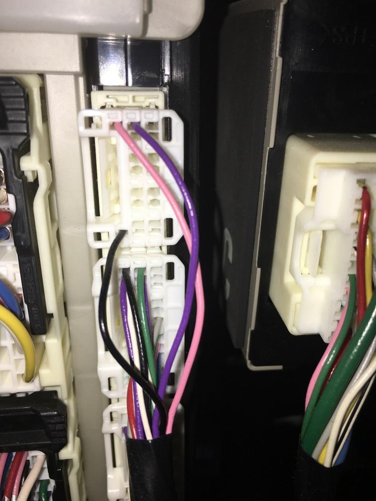

I pulled my panel apart today and was really frustrated at what I found (see pics). It appears that the secondary harness from the light sensor does not terminate at the MPX Body ECU. I looked everywhere for the sensor wires (red, blue, pink) and could not find them anywhere. Did not remove the instrument cluster to look behind there.
[MENTION=150567]Old Red[/MENTION], did you have to run more wire to join the end of the sensor wire harness to the MPX Body ECU with the parts listed in your previous post? Also, just so others know, the MPX Body ECU on a 2015 SR5 Prem is located to the left of the steering wheel right behind the windshield defrost and inverter buttons on the "knee panel". At least I now know why the sensor doesn't work... I appreciate your help and suggestions!
Just wanted to post my results. NOT all SR5 PREMIUMS are fully wired to work out of box with a light sensor. Mine is a 2015 SR5 Premium, and this is no "5 minute mod" for me I'm afraid.

I tried your suggestion using TechStream v12 before tearing my lower dash apart to inspect further. Looks like my sensor isn't fully wired to MPX Body ECU despite the dummy sensor in-dash having a harness. Just posting to save somebody else the frustration. Thanks!

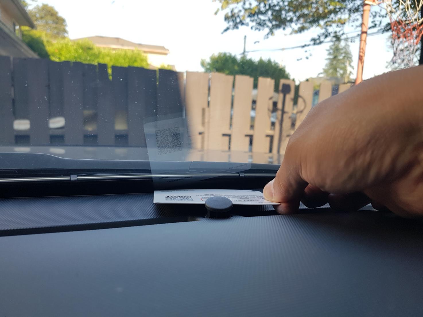

I found it easier to use a credit card and pry from the window side of the dummy cap. There seems to be a bit of a lip exposed enough to insert a credit card and lift up.
it was a 1-minute job, thanks for the tips
